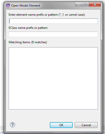

no the open model element dialog in the navigate menu / cmd+shift+F3 / crtl+Shift+F3 on windows if i remember correctly
Re: xtext cross-reference from another location [message #1741654 is a reply to message #1741652] Fri, 26 August 2016 11:29 Go to previous messageGo to next message

Re: xtext cross-reference from another location [message #1741655 is a reply to message #1741654] Fri, 26 August 2016 11:35 Go to previous messageGo to next message
sure you have build automatically on? and have built the project?
did you disable the builder in your language?
what does the dialog show with the hello world example?
Re: xtext cross-reference from another location [message #1741659 is a reply to message #1741655] Fri, 26 August 2016 12:04 Go to previous messageGo to next message
hello world example showing all matches in open dialog
Re: xtext cross-reference from another location [message #1741660 is a reply to message #1741659] Fri, 26 August 2016 12:11 Go to previous messageGo to next message
then there must be some customization in your code that prevents that
- IQualifiedNameProvider
- IDefaultResourceDescriptionStrategy
and double check you have build automatically on, the project having xtext nature and did a clean build in the workspace
Re: xtext cross-reference from another location [message #1741661 is a reply to message #1741660] Fri, 26 August 2016 12:39 Go to previous messageGo to next message
I removed xtext nature of the project. Maybe it is a problem?
Re: xtext cross-reference from another location [message #1741662 is a reply to message #1741661] Fri, 26 August 2016 12:41 Go to previous message
YES !!!
