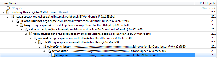

I have an issue with one of my custom EMF editor. When I close the editor, it is not fully garbage collected.
My issue is that the editor itself is scattered into multiple pieces so I can't really remove all the references pointed by the editor itself, so I wanted to free the editor itself (which sound logic to me).
However, it is not freed, and when I take a look with memory analyzer and look at the path to the root, it is kept by its action bar contributor (EditingDomainActionBarContributor) via the attribute "activeEditor" (see screenshot).
When I dispose the editor, I call setActiveEditor(null), but it doesn't reset the attribute.

I'm sorry, I think at the end it is not a bug.
I've looked at existing issues, and further into the code, and I think my issue was at a higher level. The issue was not that the ActionBarContributor didn't release the editor, but the fact that the ToolbarManager didn't release the ActionBarContributor.
I think I found my issue, it was that I removed some contributions from the toolbar manager before disposing the toolbar manager, so the removed contribution were not disposed and so the ToolbarManager still kept a reference to them, or something like that.
