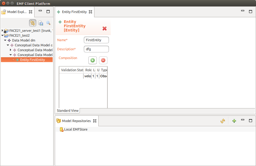

Regarding the issue with the element editing, i've attached an image showing the narrow width editing pane. If I edit a field, or resize the parent window, the panel expand to fill the document area as its supposed to. I'm running the e3 demo product for this, but I see the same result with the e3 demo feature.

Re: [EMFForms]Trouble with Table Control domain model reference [message #1741862 is a reply to message #1741832] Tue, 30 August 2016 04:57 Go to previous message
Hi Bill,
the error is a known gtk2 vs gtk3 problem. Using gtk2 everything works.
In e4 probably a layout is triggered somewhere.
To fix the issue with 3x you can do the following:
Run Config -> Environment-Tab -> new entry with key="SWT_GTK3" and value="0"
Cheers
