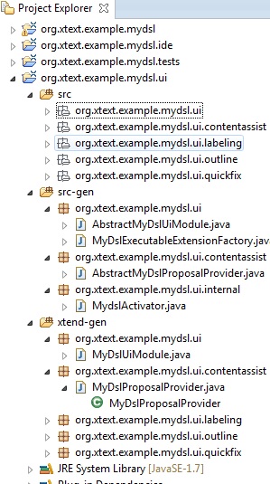

Re: Auto Completion [message #1741165 is a reply to message #1741150] Tue, 23 August 2016 08:48 Go to previous messageGo to next message
This is my Xtext project workspace
  • Attachment: Untitled.jpg
    (Size: 84.42KB, Downloaded 187 times)
Re: Auto Completion [message #1741166 is a reply to message #1741165] Tue, 23 August 2016 08:49 Go to previous messageGo to next message
the class should be accessible from there

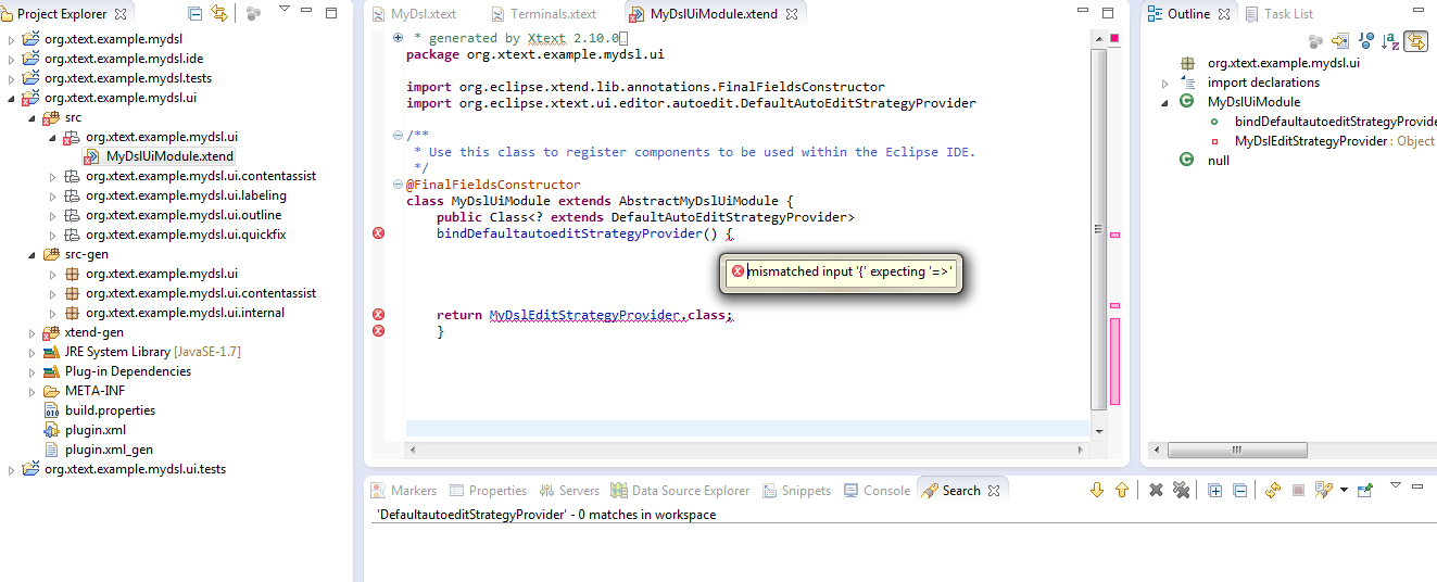

Okay I did something in the MyDslUiModule and now I can find that class which you mentioned but is shows some error.
I have attached a screen shot of it
  • Attachment: Image2.png
    (Size: 92.66KB, Downloaded 220 times)
Re: Auto Completion [message #1741237 is a reply to message #1741236] Wed, 24 August 2016 01:26 Go to previous messageGo to next message
well you code is java code and the module is written in xtend so you have to transform it to a xtend method
def Class<? extend InsertBaseClassHere> bindInsertBaseClassHere() {
InsertCustomClassHere
Re: Auto Completion [message #1741241 is a reply to message #1741237] Wed, 24 August 2016 01:56 Go to previous message
Thanks for your help!
