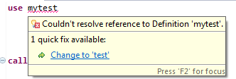

But When I am using in editor like :
defintion test
use test
working fine but when I am using
definition test
use mytest
it is showing error like index.php/fa/26884/0/
Re: Xtext: How to active hyperlink? [message #1741608 is a reply to message #1741607] Fri, 26 August 2016 05:44 Go to previous messageGo to next message
that is an actual feature. you cannot use (reference) something that is not there.
this is why you get an error about an "unresolved" cross reference.
