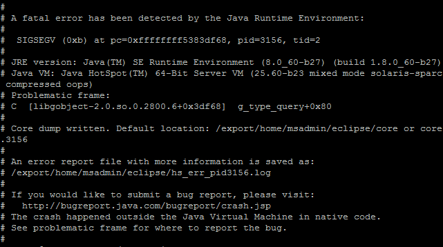

I am fairly new to Solaris, so this is tricky. I have listed my eclipse.ini file, and attached the error I receive upon launch below.

Re: Fatal Error on Launch (Solaris 11) [message #1740851 is a reply to message #1740828] Fri, 19 August 2016 01:36 Go to previous messageGo to next message
Audrey,
This a Java core dump, perhaps caused by native GTK code in SWT. I
don't think the sparc arch is well supported and I believe support for
it will be dropped:

Re: Fatal Error on Launch (Solaris 11) [message #1744312 is a reply to message #1741209] Sat, 24 September 2016 15:01 Go to previous message
A similar problem happened back with Ubuntu 13.10 and 14.04 The problem is discussed in this thread:
https://bugs.launchpad.net/ubuntu/+source/unity/+bug/1241101
I got Neon working under Solaris 11.3 by fudging the call specified in the debug log to use "" rather than null and recompiling SWT, however there should be a better way of fixing this - Eclipse SWT shouldn't be creating GTK widgets with null values since it will keep showing up on different calls with different versions of GTK.
