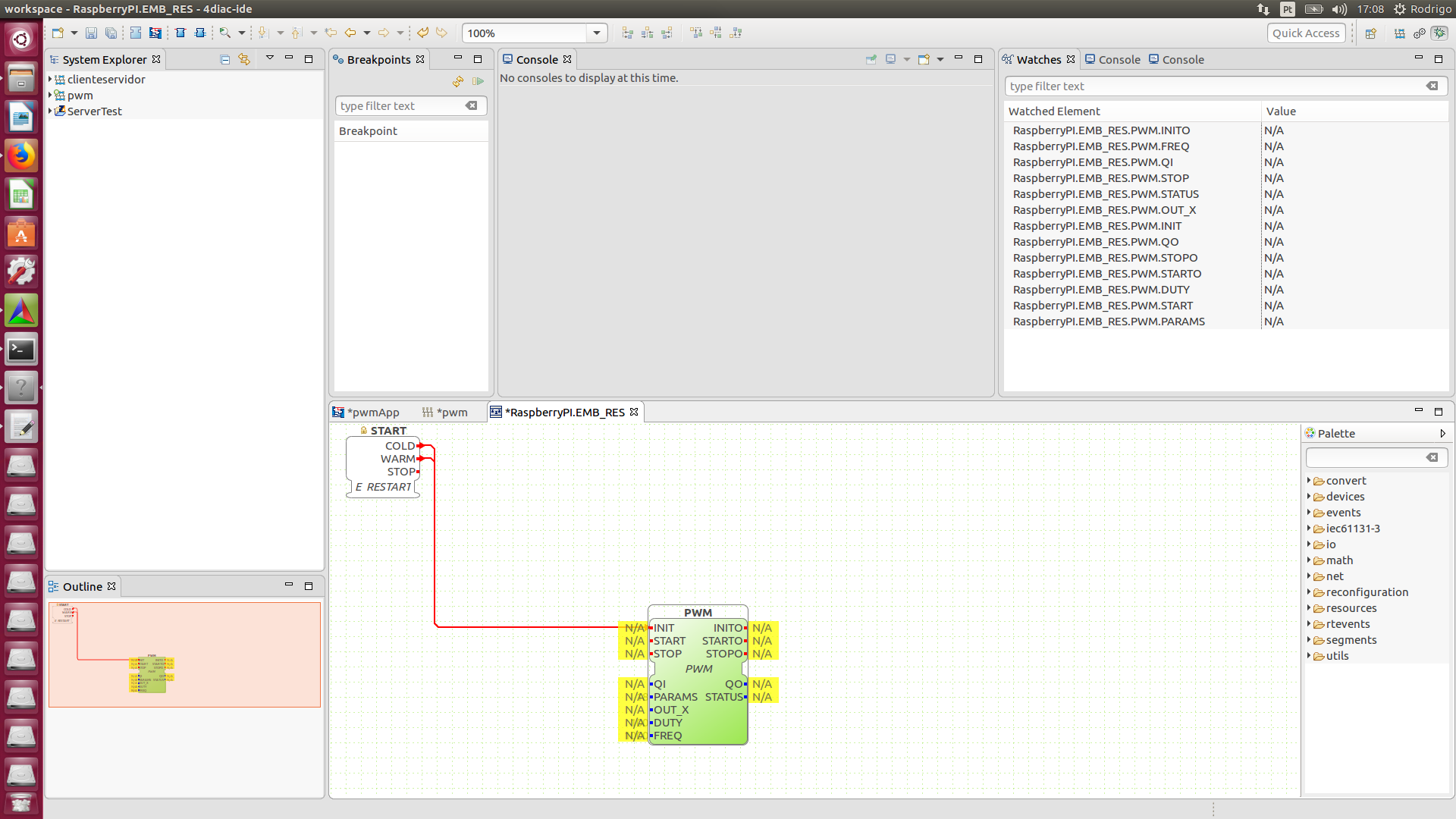

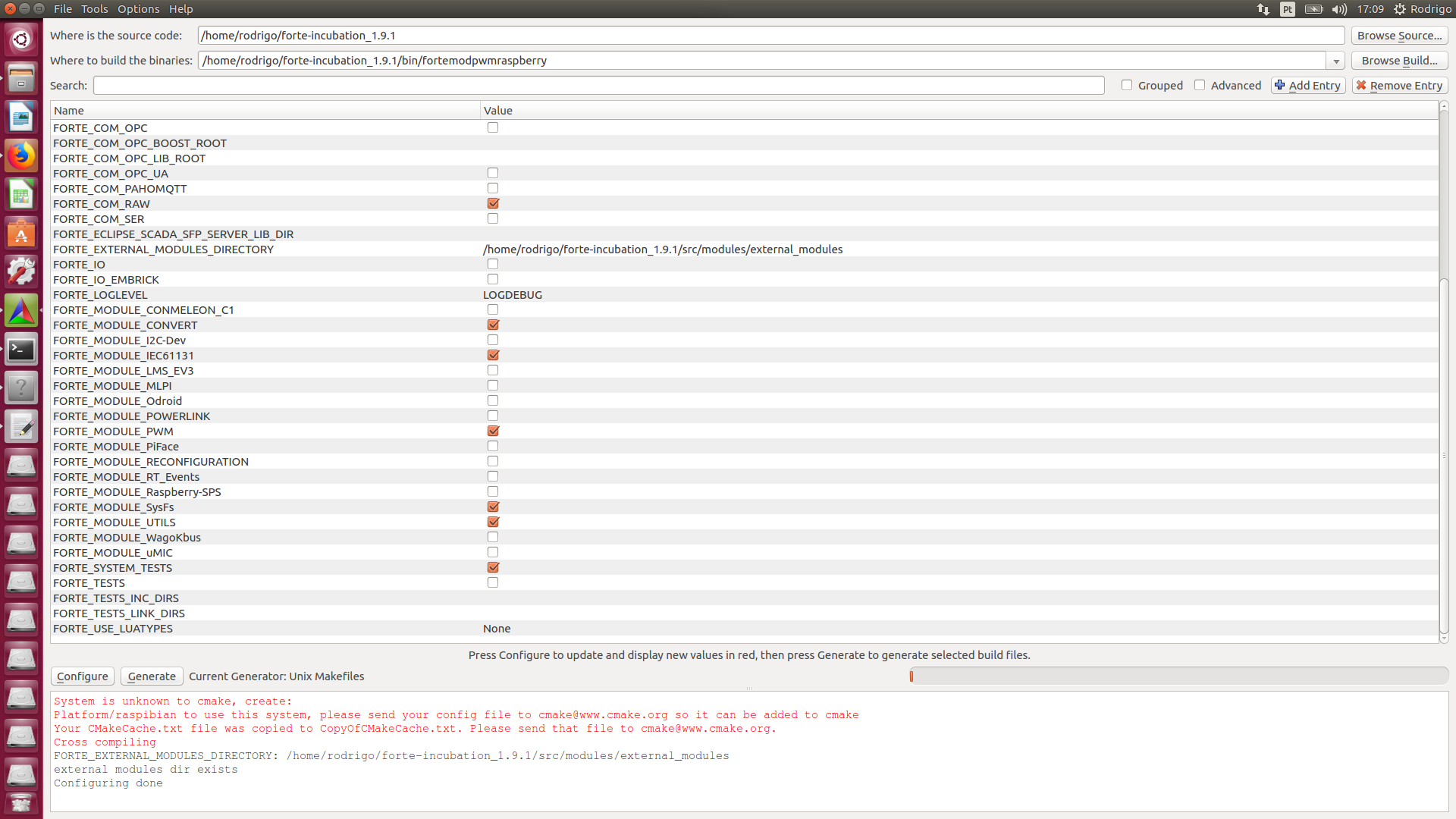

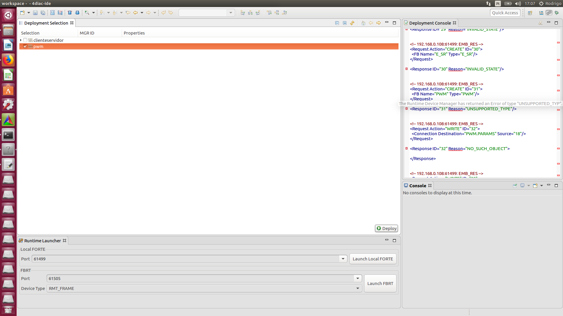

I'm trying to use the pwm block and I'm having this Response ID: "Unsupported_Type" The runtime Device Manager has returned an Error of type Unsupported_Type . In the images are the console outputs. I'm running the fort on raspberry and the version was built according to image 3. Could someone help me? I have the wiringPi library installed on raspberry and I ran a test with an application in c and it worked.
Re: How to add wiringPi library to access the softPWM functions. [message #1795205 is a reply to message #1795176] Tue, 18 September 2018 07:25 Go to previous messageGo to next message
If you are getting unsuported type it typcially means that the forte you are running does not contain the FB. Have you ensured that during recompilation of FORTE the cpp file of your pwm was compiled. I noticed that in some odd cases the build process didn't generate a forte executable. Therefore it make sense to check if the data of your forte executable file has changed (this costed me last week at least half an hour error searching).
Then if you have several fortes are you starting the right one.
Finally is there already a forte running on your system, e.g., started from systemd or init.d. Better check with ps -aux | grep forte and if yes kill it first.
Re: How to add wiringPi library to access the softPWM functions. [message #1795232 is a reply to message #1795205] Tue, 18 September 2018 16:46 Go to previous messageGo to next message
I was compiling it an external module and it was not working, so i just created a directory under src/modules and cmake could read and compile in the right way. Thank you once again!
