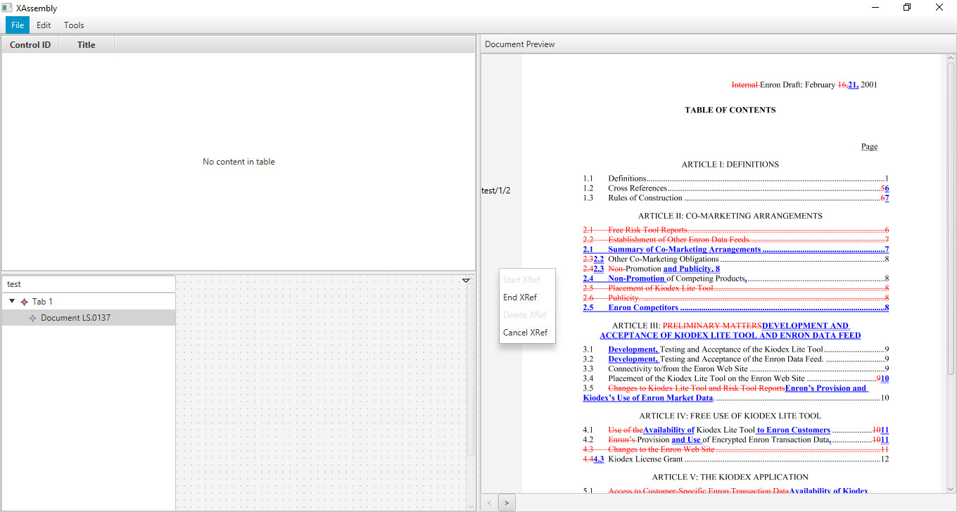

Hi Tom
This attached screen shot shows a cross reference on a document on the right hand side. (This is the Text control showing "trial/1/2" in the left hand margin of the document)
A new cross reference is added by clicking "End XRef" on a popup menu, also shown.
The handler needs to know where on the document the popup was triggered in order to know where to place the new cross-refererence on the document.
That means getting some info about the triggering event, or the position of the popup, into the handler attached to the End XRef menu item.
MPopupMenu at the moment has no access to the triggering mouse event, or the position of the popup. Hence the clunky workaround by getting hold of the rendered component which I agree is less than ideal.
Could MPopupMenu eventually contain some triggering data do you think? It seems to me that popups will quite often need to pass positional data to handlers - e.g. adding components to a diagram via a popup etc.
Robert
