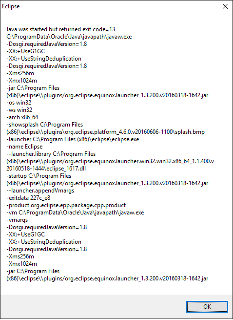

index.php/fa/26716/0/Can someone tell me whats going on with this? I'm new to this IDE and I want this really badly working today! Thanks!

Hi, Sorry to hear you have run into a problem, hopefully I can help.
This problem is almost certainly because you have a 32-bit/64-bit mismatch between your Java (JVM) and Eclipse installations.
From what I can tell in your screenshot your Eclipse install is 64-bit, which would imply that your JVM install is 32-bit. If you have both 32 and 64 bit JVMs on your machine you can use the -vm argument to Eclipse to specify which one to use. Have a look at https://wiki.eclipse.org/Eclipse.ini
Here is a stack overflow answer with more help: http://stackoverflow.com/questions/4945178/cannot-run-eclipse-jvm-terminated-exit-code-13
