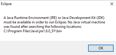

Hello, I have installed eclipse neon on my windows 10, created the proper Path and entered the right JAVA_HOME path.
When I was finished eclipse ran fine.
After this I have installed Android Studio on worked on that for a while.
Now trying to start eclipse I get the following message:
**running javac on cmd works just fine
help!
  • Attachment: Capture.PNG
    (Size: 5.72KB, Downloaded 518 times)
Re: Eclipse won't start after Android Studio install [message #1739738 is a reply to message #1739721] Thu, 04 August 2016 09:01 Go to previous messageGo to next message
Maybe you installed a Java update and that folder no longer exists.
> help!
Re: Eclipse won't start after Android Studio install [message #1739739 is a reply to message #1739738] Thu, 04 August 2016 09:13 Go to previous messageGo to next message
I have tried reassigning the path.. it still doesn't work.
Plus javac on the command line works
Re: Eclipse won't start after Android Studio install [message #1739810 is a reply to message #1739739] Thu, 04 August 2016 12:11 Go to previous messageGo to next message
Look at the Announcement posts at the top of this forum - there is one about what to do if Eclipse won't start.
Hint: don't rely on JAVA_HOME or system path - there's a better way.
[Updated on: Thu, 04 August 2016 12:12] by Moderator
Re: Eclipse won't start after Android Studio install [message #1739977 is a reply to message #1739810] Sat, 06 August 2016 07:51 Go to previous messageGo to next message
Interesting... I'll check it out and post the results Smile
Re: Eclipse won't start after Android Studio install [message #1741870 is a reply to message #1739810] Tue, 30 August 2016 06:33 Go to previous message
Works perfectly now.
Thank you!
