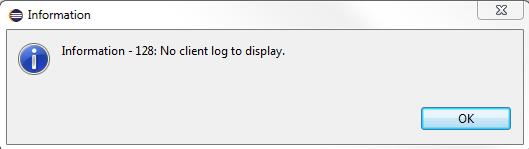

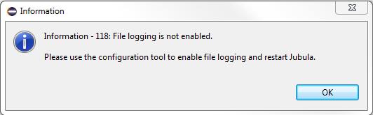

Hello Alex,
logging is not enabled in my eclipse installation - there was no "logs" directory under .jubula, only the database was there, and I just got a message to enable the logging under "help/show client log" - that is why I asked how to enable it (see screenshots).
index.php/fa/26699/0/index.php/fa/26700/0/
The logs directory was eventually created after trying the standalone, but still no logs from the eclipse plugin.
I'll try a clean installation of eclipse, without any other plugins, when I get some extra time...
Thank you,
Calos.
