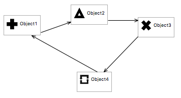

Hi all Smile,
I'm creating a dsml that draws diagrams with states(nodes) and transitions(links). I need to get the objects in a EGL code to create the output of my diagram. But, I have to know the order of nodes and links. If the diagram is something like this image:
index.php/fa/26630/0/
I have to know that Object1 have a link to Object2; Object2 has a link to Object3; and all others link also.
How can I do this?
I know how get the objects but they appear in the order that was added to the diagram.. But that isn't necessary the order that I need.
Thank you all in advance Smile

If you need to specify that Object1 is the first state in your model, you need to add a respective boolean attribute (e.g. isStart) in your metamodel and set it to true for Object1 and to false for everything else (alternatively you can introduce an InitialState class that extends your State class and make Object1 an instance of the prior). Does this answer your question?

Hi, thanks for your answer. If I know the first state, how can I get the next instance?
Re: Getting links with EGL [message #1739367 is a reply to message #1739366] Sat, 30 July 2016 15:35 Go to previous messageGo to next message
This depends on your metamodel. Could you please post a copy of your metamodel - preferably a minimal fragment in Emfatic - so that I can advise?

Re: Getting links with EGL [message #1739371 is a reply to message #1739370] Sun, 31 July 2016 00:39 Go to previous messageGo to next message
Since your model can contain cycles (as illustrated in your initial diagram), there's no "natural" starting point, and as such one needs to be defined explicitly. After adding an isStart attribute to the Statements class, you can find the starting Statements object as follows:
var startStatements = Statements.all.selectOne(s|s.isStart);
To find the "next" Statements of a give Statements element you can use a function like the one below:
operation Statements getNext() {
  return Transition.all.select(t|t.source = self).collect(t|t.target).flatten();
Cheers,
Dimitris

Re: Getting links with EGL [message #1739396 is a reply to message #1739371] Sun, 31 July 2016 14:34 Go to previous messageGo to next message
Hi Dimitrius,
It works. Thank you!
