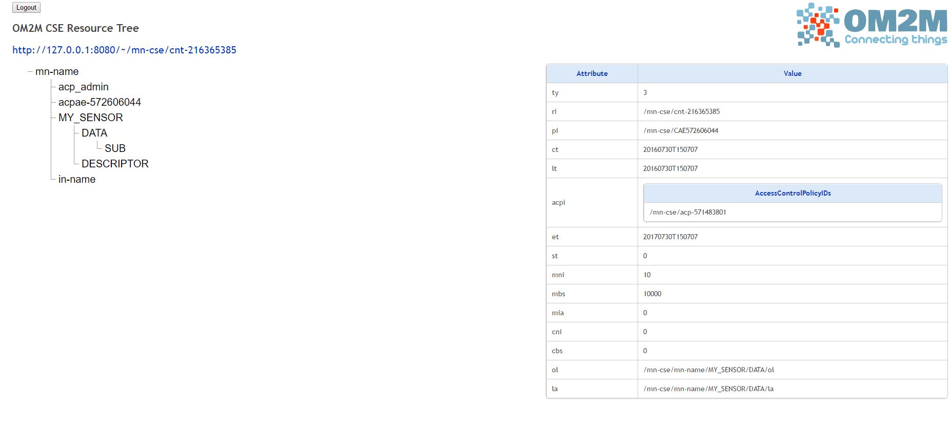

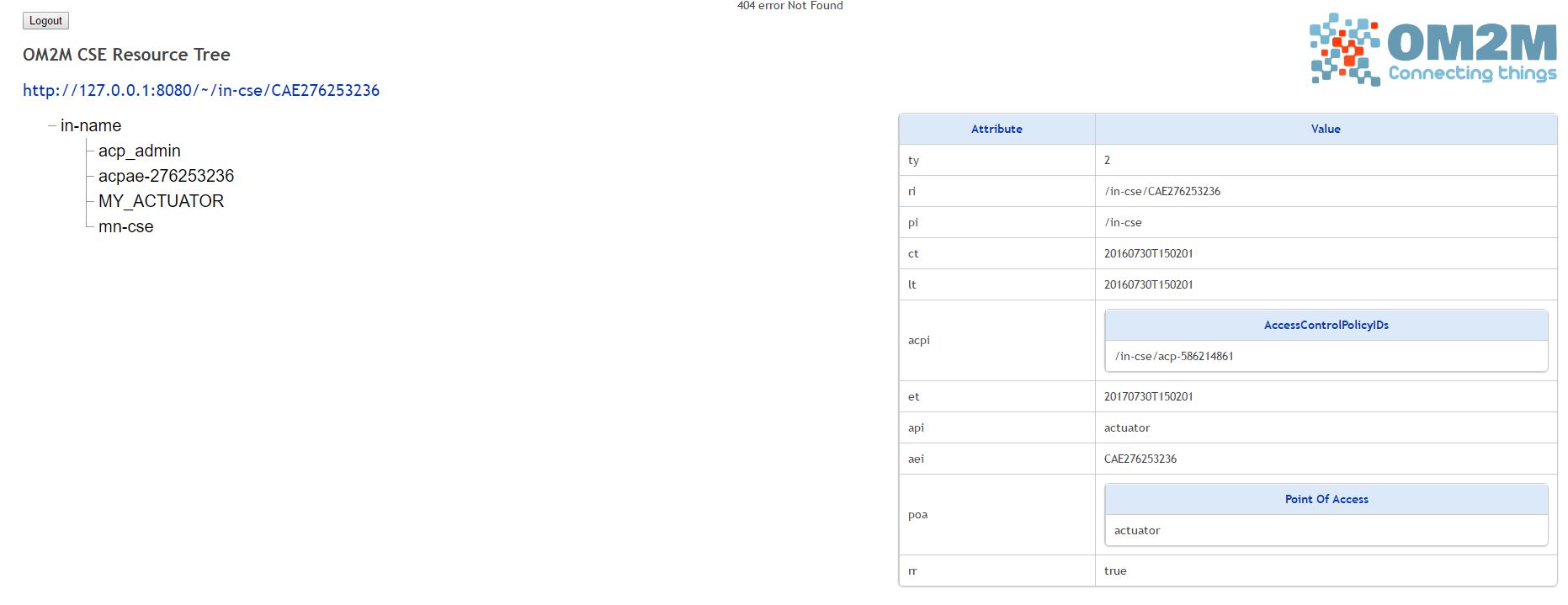

Hi everyone,
I have a situation like: AE MY_ACTUATOR in IN will subscribe to AE MY_SENSOR/DATA in MN. However when I run these two plugins, I got the 4103 error, like the log file below showed:
IN side:
index.php/fa/26627/0/

MN side:
index.php/fa/26628/0/

I think the problem came from my POA and NU address. In MY_SENSOR, I set the NU address to be the address that the notification message need to be sent to, in this case this is the address of AE MY_ACTUATOR:
Subscription sub = new Subscription();
sub.getNotificationURI().add("/in-cse/in-name/MY_ACTUATOR");
And about the POA address, I am still abit confused how to set it correctly, so I kept it to be my ipeId, in this case is sample, like in the tutorial in the OM2M website:
ae.getPointOfAccess().add(ipeId);
I think the problem came from here. Does anyone have an idea how to fix this error?
Thank you so much
Son
  • Attachment: incse.JPG
    (Size: 83.18KB, Downloaded 1218 times)
  • Attachment: mncse.JPG
    (Size: 97.25KB, Downloaded 1006 times)
Re: how to set the POA address for AE correctly? [message #1739362 is a reply to message #1739354] Sat, 30 July 2016 11:19 Go to previous message
Related topic:
https://www.eclipse.org/forums/index.php/m/1739361/#msg_1739361
Opened Bug 498911: Error in Access Right verification for PoA notification:
https://bugs.eclipse.org/bugs/show_bug.cgi?id=498911
OM2M Patched version: OM2M-DEV-30072016
https://wiki.eclipse.org/OM2M/Download
Previous Topic:why do we need mn cse and in cse?
Next Topic:responseStatusCode=4103 (Unknown or unauthorized originator) when notify to AE resource
