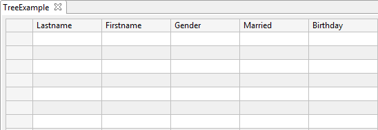

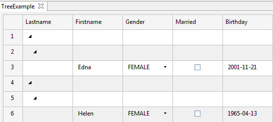

Because of your reply I checked again and when I use the following values the padding seems to be ignored:
.modern {
	tree-structure-painter: background padding tree;
	table-border-color: auto;
	cell-background-color: white;
	text-align: left;
	row-height: auto; /* I added this line */
	padding: 10 10 10 10; /* I increased the values */
index.php/fa/26646/0/
Please note that the cells width/height is not adjusted at all and thus any information is actually hidden. In the example given when I manually increase the row height by maybe 2 pixels with the mouse the rows autoexpand(!) and all the information is there with the correct padding. Can you reproduce this behaviour? Is it me abusing CSS or is this a bug? If smaller values are used everything is working as expected. For example:
row-height: auto;
padding: 5 10 10 10;
works for me.
index.php/fa/26645/0/
If "row-height: auto" is not given the information may be cut but is still visible to some extend, i.e. the information is being moved out of the visible part of the cell.
