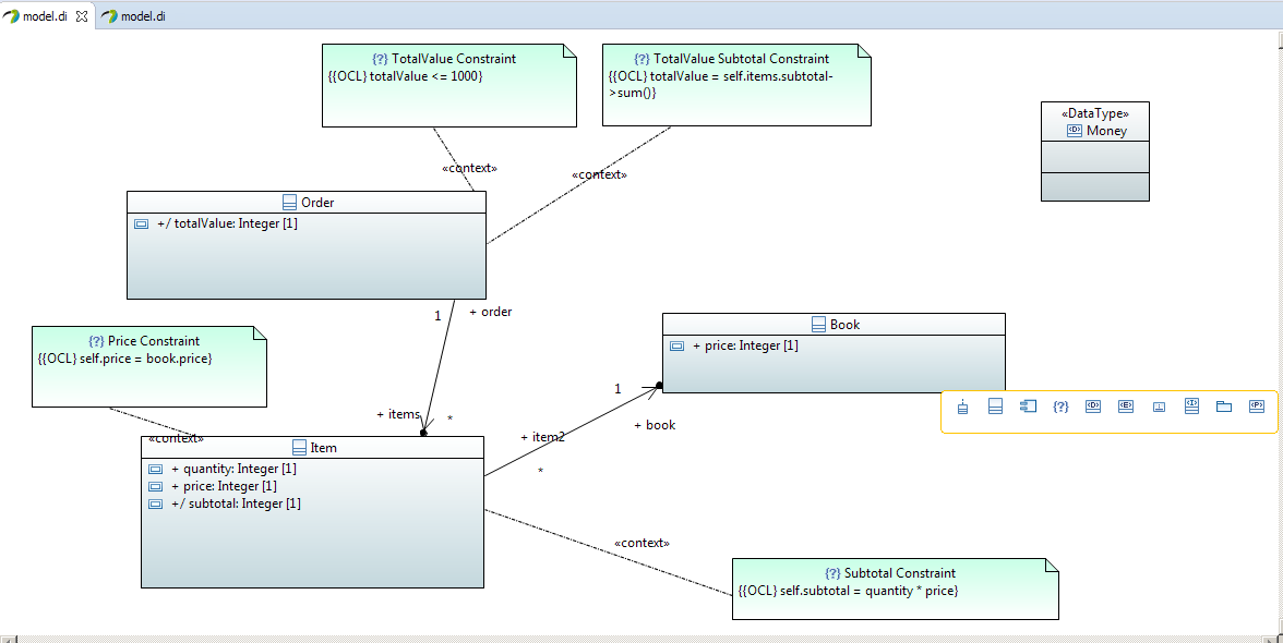

I've modeled the Book Order System described on page 150 of Object-Oriented Analysis and Design for Information Systems, by Raul Sidnei Wazlawick:
index.php/fa/26569/0/
Althought the following two OCL constraint expressions are validated by the Eclipse OCL interpreter:
totalValue = items->sum()
totalValue = self.items.subtotal->sum()
... the following isn't (although it's recommended by the book author):
self.item->sum(anItem|anItem.subtotal)
Is the author using an non-standard version of OCL or are list comprehensions not "understood" by the Eclipse OCL Interpreter?
  • Attachment: Order.png
    (Size: 46.89KB, Downloaded 635 times)
[Updated on: Tue, 26 July 2016 04:29] by Moderator

Presumably you meant (missing "s")<br>
<pre wrap="">self.items-&gt;sum(anItem|anItem.subtotal)</pre>
Currently the OCL specification gives no consideration to
comprehensions, although some consideration was given to it at the
Aachen workshop [1]. I can only conclude that your author was
being a little optimistic.<br>
<br>
Strictly speaking the 'not understood' is in the OCL standard
library rather than in OCL. The new Pivot-based OCL has a library
model in which iterations are modelled and so you could add a
"sum" iterator, however the co-existence of an iteration and an
operation with the same name may provoke a latent bug.<br>
