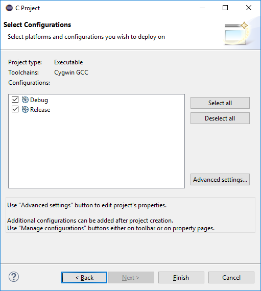

Hi Taro,
Not sure why you have only one configuration, in the new project wizard you could have(?) unchecked the Debug configuration:
index.php/fa/26582/0/
You can edit the configurations in the project properties and you can change the current configuration by, Right-click on project, Choose Build Configurations, Set Active, Choose Debug/Release.
As for the error message, this is probably a side effect of the system call leaving the main program in a system sleep. On Windows interrupting child processes is difficult to say the least. (there was a discussion on this topic a few years ago https://dev.eclipse.org/mhonarc/lists/cdt-dev/msg17490.html). Do you get this error message all the time, or only around the system call?

Re: Main() is suspended upon debugging: Is this normal? [message #1739338 is a reply to message #1739104] Fri, 29 July 2016 20:18 Go to previous message
Thank. The project is a Makefile project imported from somewhere else, so it could be the project may only have 1 configuration set.
I do get the error message around the system call.
