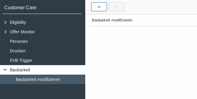

I have some AbstractPageWithNodes in the lefthand menu. And as soon as I click on an item, there will be a list of all child nodes in the main frame. (see screenshot)
Well, I'd like to have the first child of that list opened instead of that redundant child list - which will be displayed in the menu anyhow.
How can i tweak the menu to display the first child in the list?

What you describe is the default behavior of Scout. Each node in the outline tree on the left is linked to a specific content on the right. A page with sub-nodes does not display any content of the sub-nodes by default, because it usually is not semantically appropriate. It is also not easy to tell which is the "first" node, because the child nodes might be ordered or filtered in a special way. For example, when you have a "Persons" folder with "Alice", "Bob" and "Charlie" as child nodes, you don't see Alice's data when you click on "Persons". Instead you see a list of persons, possibly with a search form.
What exactly is your intention? When you select "Baubarkeit", would you like to see the content of "Baubarkeit modifizieren"? Is the number of child nodes of "Baubarkeit" dynamic? Can you have more than one? If you just want to switch between a "view mode" and an "edit mode" of an item, the usual pattern would be to have a detail form with a "read only" form handler on the node page, including an "edit" menu that opens the same form again with a "modify" form handler.
Another possibility is that you want to automatically select the "Baubarkeit modifizieren" node as soon as the user selects "Baubarkeit". This could be achieved by overriding "execPageActivated()" in your node page and programmatically changing the selected node in the outline tree.

The outline tree works for us as a menu, where users can open "Baubarkeit" and select one of the items below. Here's only one item "Baubarkeit modifizieren". So our idea is, that on click on "Baubarkeit" the menu opens (with "B.M.") AND at the same time the "B. M." page opens. It's just one click less for the user.
Now the user has to click twice, first on "B." and second on "B.M." Well, the menu is almost static, there's no dynamic data loading. So we never have "Alice", "Bob" or "Charlie" in the Menu as child nodes. To prevent any data added to the menu we added

YES, this is exactly what we're intended to do: open first child on click on the "parent" node!
Thank you!
This is the code we're searching for:
