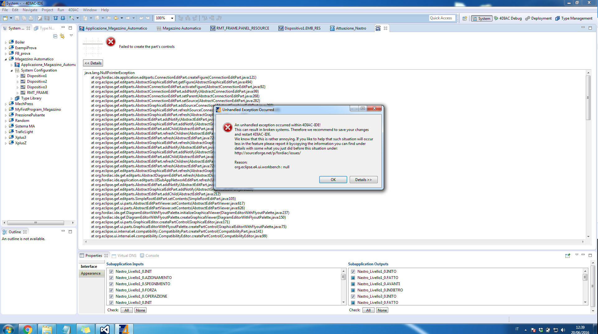

When I create and use a SubApplication (example, in the creation of I/O), it can happen un error of type null pointer.
This situation causes the end of Subapplication, not more accessible.
Even if I remove the I/O of SubApplication, I don't succeed to remove it from my application.
I ask you, it is my error of "programming"?
Or, it is a problem of 4DIAC?
It seems me a loss of syncronization.
I use version 1.8M1 of 4DIAC.
I attach the result that is showed.
Michele Citro
  • Attachment: error2.png
    (Size: 257.77KB, Downloaded 137 times)

currently subapplications are unfortunately rather fragile. We started a major code-clean project to improve the situation. However this will not be available for the 1.8. Therefore I currently suggest to not use subapplications.
Alois
