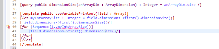

Laurent, I also tried simply to generate the text result of the query and indeed I get the expected value. In my test model my "arraySize" equals 6 and in the generated file I see a printed value of "6".
Also the attached image shows what I see in my mtl editor. The associated error problem is "First and last type mismatch: (1..myIntArraySize)"

Re: for loop Sequence type mismatch [message #1738744 is a reply to message #1738738] Fri, 22 July 2016 15:47 Go to previous messageGo to next message
HI
Try putting "1" in a let variable too. If your problem is metamodel
schizophrenia, you must use identical types in paired situations. And
make really sure a rebuild has occurred. In the past I found that time
could be wasted debugging a stale compilation.

Re: for loop Sequence type mismatch [message #1738802 is a reply to message #1738744] Sun, 24 July 2016 17:35 Go to previous messageGo to next message
Ok I got it working. I actually had two problems. The first was metamodel Schizophrenia within my own metamodel, which defined a class called "Integer". I can see now why that was very bad. The second was that my "arrayDim.size" type was metamodeled as an "Elong" which wasn't compatible with Acceleo "for" loop or "let" statement assignments for some reason. I needed to switch the metamodel of the size to "Int [int]" in my ecore model.
Any idea why casting an Elong to an Integer in acceleo would cause a let or for loop statement not to execute? Just curious for my own learning.
Thank you everyone for your help. Wonderful support group here!
Re: for loop Sequence type mismatch [message #1738816 is a reply to message #1738802] Mon, 25 July 2016 04:07 Go to previous messageGo to next message
Actually, this is a use case that should work in Acceleo if I'm not mistaken.
This is your real issue. EMF will not consider an integer to be compatible with type ELong, so Acceleo won't either. That is due to how "isInstance" checks are implemented in EMF, you can take a look at EClassifier.isInstance(Object) for your information. Basically, for the "ELong" classifier, the only object that will be considered compatible are instances of "java.lang.Long", which integers are not.
