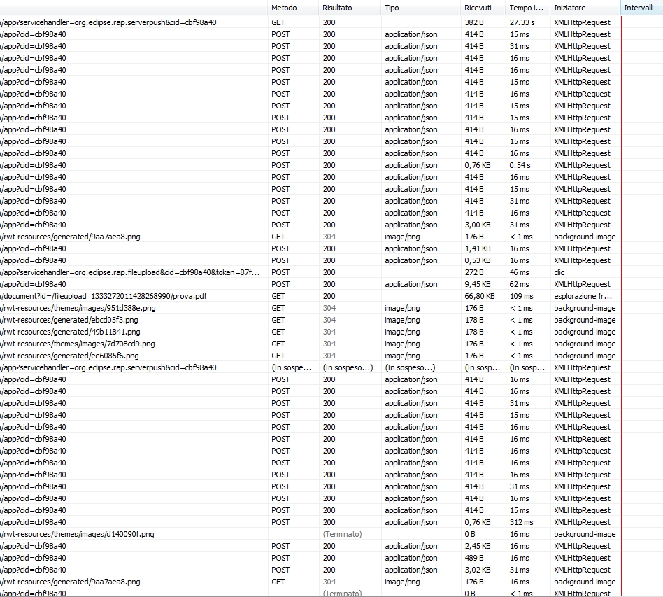

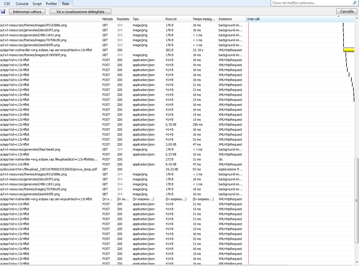

I am including some screenshots of the network traffic details when the problem occours.
The problem seems related to occsasionally slow RAP file upload processes.
