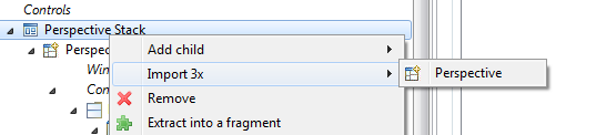

Hi Patrik, yes i get modelService and application via injection. Here is my code
public class ShowPyDevPerspective
	@Execute
	public void execute(MApplication app, EPartService partService, EModelService modelService)
		MPerspective element = (MPerspective) modelService.find("org.python.pydev.ui.PythonPerspective", app);
		partService.switchPerspective(element);
I need add perspective like i show in the image ?
index.php/fa/26498/0/
Thanks for the anwser.

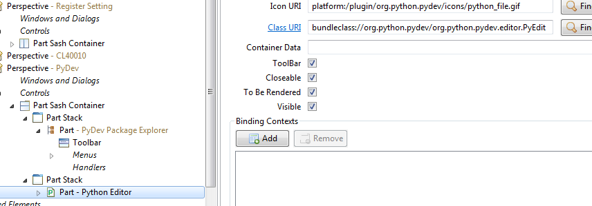

Hi Tom, yes i add the compability layer.
and add the perspectives importing like the last picture and continuos importing 3.x and i can see the corresponding class, but when i run my rcp in the perpesctive show the title but not the content.
index.php/fa/26499/0/
Thanks.
