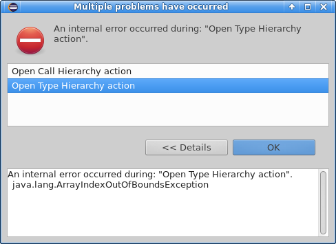

Recently I've installed Eclipse Neon IDE. I created new workspace and imported all my Java and PHP projects into it (from Luna workspace). Now hierarchy errors occures while PHP coding: sometimes after save changes or some different action. Error popup looks like image in attached screeshot.
Honestly I'm tired from these errors. They occure very often and the cause of it is not clear. I've tried to unset all keys related with Hierarchy module, no effect.
Why the error occures? I didn't face such errors on Luna. How to win it? It's impeding my work. I also tried to close and reopen my projects, no effect
I use Eclipse Neon IDE, PDT 4.0.0, DLTK 5.5.0
Ubuntu 16.04, GTK2

My Neon workspace is fresh, I imported only my projects from old workspace. No old workspace setting was imported

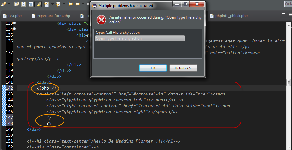

Re: "Open call hierarchy action" error [message #1738138 is a reply to message #1738040] Sat, 16 July 2016 01:29 Go to previous messageGo to next message
index.php/fa/26482/0/eclipse.buildId=4.6.0.I20160606-1100
java.version=1.8.0_92
BootLoader constants: OS=win32, ARCH=x86_64, WS=win32, NL=en_US
Framework arguments: -product org.eclipse.epp.package.php.product
Command-line arguments: -os win32 -ws win32 -arch x86_64 -product org.eclipse.epp.package.php.product
org.eclipse.core.jobs
Error
Mon Jul 16 11:01:35 ICT 2559
An internal error occurred during: "Open Call Hierarchy action".
java.lang.ArrayIndexOutOfBoundsException
at java.lang.AbstractStringBuilder.append(AbstractStringBuilder.java:570)
at java.lang.StringBuffer.append(StringBuffer.java:369)
at org.eclipse.php.internal.core.util.text.TextSequenceUtilities$CompositeTextSequence.toString(TextSequenceUtilities.java:301)
at org.eclipse.php.internal.core.codeassist.PHPSelectionEngine.internalResolve(PHPSelectionEngine.java:565)
at org.eclipse.php.internal.core.codeassist.PHPSelectionEngine.select(PHPSelectionEngine.java:148)
at org.eclipse.dltk.internal.core.Openable.codeSelect(Openable.java:679)
at org.eclipse.dltk.internal.core.Openable.codeSelect(Openable.java:695)
at org.eclipse.dltk.internal.core.AbstractSourceModule.codeSelect(AbstractSourceModule.java:91)
at org.eclipse.dltk.internal.core.AbstractSourceModule.codeSelect(AbstractSourceModule.java:85)
at org.eclipse.php.internal.ui.util.PHPSelectionUtil.getSelectionModelElement(PHPSelectionUtil.java:65)
at org.eclipse.php.internal.ui.actions.OpenCallHierarchyAction.isEnabled(OpenCallHierarchyAction.java:148)
at org.eclipse.php.internal.ui.actions.OpenCallHierarchyAction.access$0(OpenCallHierarchyAction.java:142)
at org.eclipse.php.internal.ui.actions.OpenCallHierarchyAction$1.run(OpenCallHierarchyAction.java:95)
Re: "Open call hierarchy action" error [message #1738143 is a reply to message #1738040] Sat, 16 July 2016 03:15 Go to previous messageGo to next message
Error
Re: "Open call hierarchy action" error [message #1738495 is a reply to message #1738143] Wed, 20 July 2016 06:51 Go to previous messageGo to next message
Thank You. Your problem is described here: https://bugs.eclipse.org/bugs/show_bug.cgi?id=497821
We fixed it in current nightly. If you want try it, just add http://download.eclipse.org/tools/pdt/updates/latest-nightly/ (this link also contain instruction how to use it).

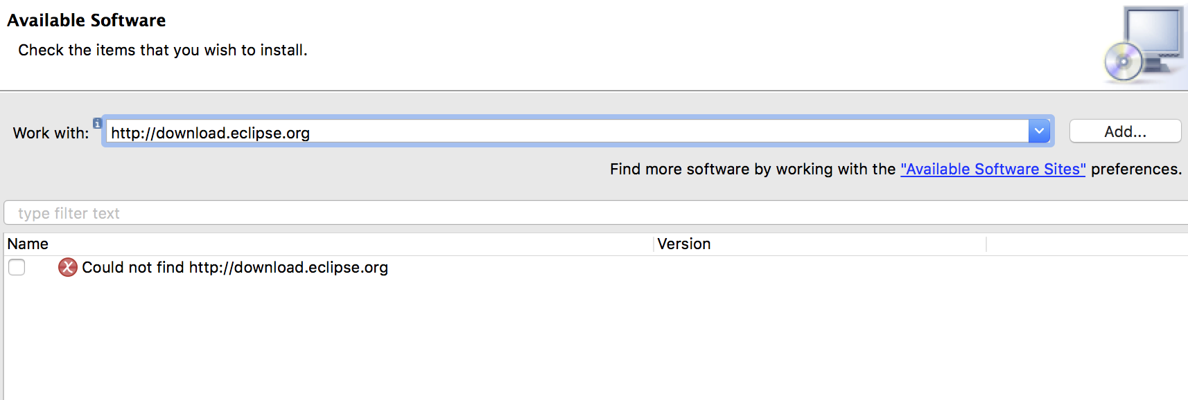

Re: "Open call hierarchy action" error [message #1743486 is a reply to message #1738035] Thu, 15 September 2016 16:28 Go to previous message
I got the same problem but for some reasons the solution for this issue does not work for me. The solution I mean is this link:
the attached picture shows I can not add anything into it.
