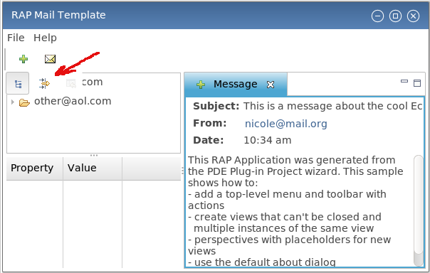

Dear RAP programmers,
I found that the toolbar buttons from the PropertySheet are not positioned correctly with RAP (see attachment). Is this a bug, or am I not using the PropertySheet the right way?
index.php/fa/26440/0/
Steps to reproduce:
1) Create a Plugin Project from "RAP Mail Template".
2) insert one line in the created Perspective.java to create the PropertySheet:
layout.addStandaloneView(NavigationView.ID, false, IPageLayout.LEFT, 0.25f, editorArea);
// add next line to show a PropertySheet:
layout.addStandaloneView("org.eclipse.ui.views.PropertySheet", false, IPageLayout.BOTTOM, 0.25f, NavigationView.ID);
IFolderLayout folder = layout.createFolder("messages", IPageLayout.TOP, 0.5f, editorArea);
3) Run the project and observe the "Categories" and "Advanced Properties" buttons from the PropertyShee disturb the NavigationView as marked in red in the attachment.
Is it possible to fix the layout, so that the PropertySheet toolbar buttons get their own space so that they don't hide other elements?
