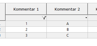

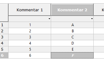

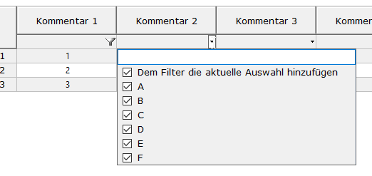

Bringing up this topic again, as we also use the combobox filter list. It would be very handy, to have the available filter values on the remaining filters, reduced to the actual visible values. See also example attached:
index.php/fa/34911/0/
index.php/fa/34912/0/
index.php/fa/34913/0/
When the list has more values, the filter is getting very confusing, showing values, which you actiually can´t select, as they re already filtered out.

The SelectRowsCommand selects the rows and shows at maximum the last selected cell. If you want to show some rows in the viewport that are not selected, you need to execute the ShowRowInViewportCommand and for that you need to know which row position (based on the SelectionLayer) is shown as last row in the viewport at that time.
IMHO you are trying hardly to work around an issue in NatTable. Not sure if that is the correct way.
