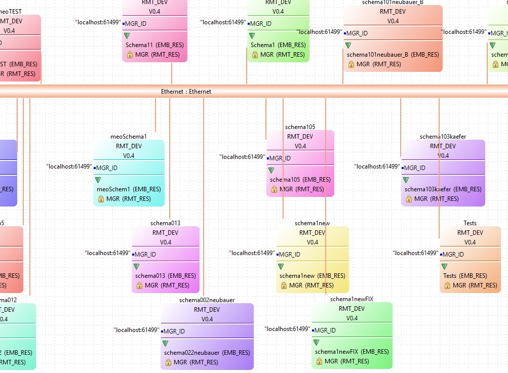

is there a limit set to add "RMT_DEV" to "System Configuration"?
When I want to add one more "RMT_DEV", 4DIAC stops working - I only can restart the program Sad Then I start again......4DIAC stops working....and so on
Thank you,
Wolfgang
  • Attachment: Unbenannt.jpg
    (Size: 291.39KB, Downloaded 121 times)
Re: Limitation of RMT_DEV [message #1737406 is a reply to message #1737352] Thu, 07 July 2016 16:26 Go to previous messageGo to next message
no there shouldn't be a limit. I tried myself and noticed that when you start a new project and start to drag in devices that 4diac-ide hangs always with the 22nd device.
Digging a bit further I found that the problem is in the random color generation. It looks like the algorithm used does not find a color with enough difference between the existing devices' colors and any new one. I have to reasearch a bit what a better color comparing algorithm would be.
