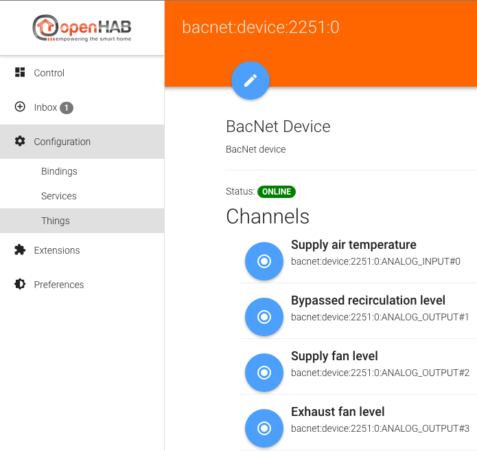

I started working on new bacent binding and I have dynamic list of channels. Bacnet is quite abstract, there is network, device and it's properties. I mapped network to bridge, device to thing and properties to channels. I'm not sure if I've done that properly cause I fetch bacnet device properties when related ThingHandler.bridgeHandlerInitialized method is called.
In same method I start thread which fetch present values and post channel updates, but these are ignored:
2016-07-05 10:50:26.673 [DEBUG] [home.core.internal.items.ItemUpdater] - Received update for non-existing item: Item 'bacnet_device_2251_0_ANALOG_VALUE_34' could not be found in the item registry
(gist with same code https://gist.github.com/splatch/657492703d452aab5214005552077cfc)

Do I miss anything in my code to get linking done? In GUI these channels are displayed properly:
index.php/fa/26381/0/
