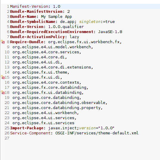

Hi there,
i'm working on a Linux 64 BIt System (Linux Mint 17.3 Rosa).
I installed a fresh Eclipse Neon Release (4.6.0) and installed the e(fx)clipse plugin and target Platform as described here: https://wiki.eclipse.org/Efxclipse.
When I create a new JavaFX7OSGI/ e4 Application Project, I get org.eclipse.fx.ui.workbench.fx, org.eclipse.fx.ui.di and org.eclipse.fx.ui.databinding not found.
Can someone help me out there?
Dieter

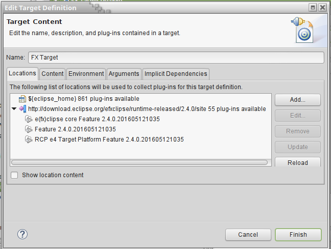

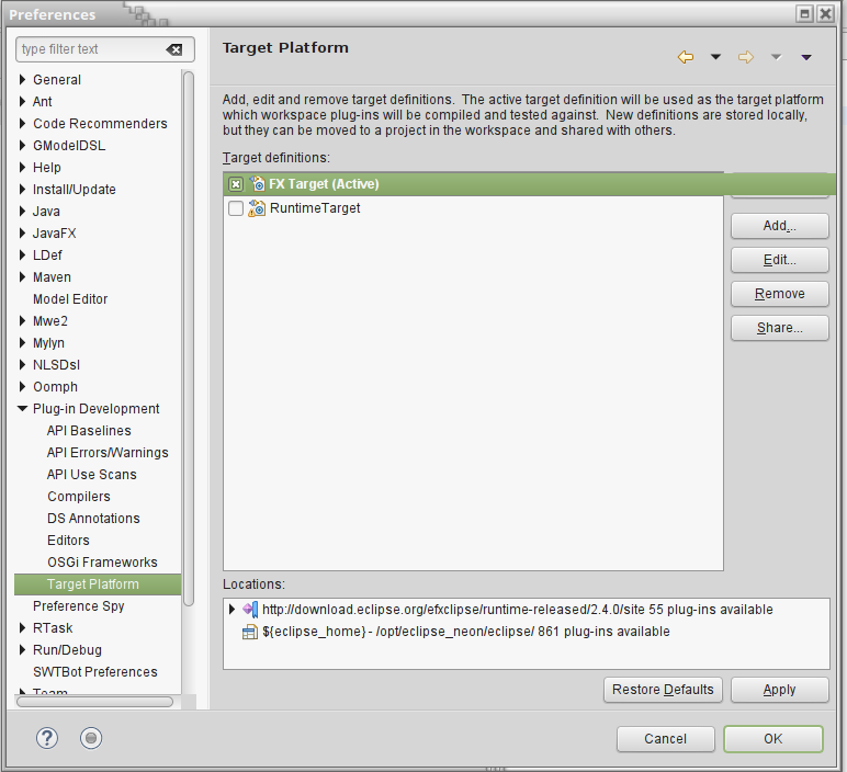

Re: Eclipse Neon 4.6.0 with E(fx)clipse 2.4.0 not working [message #1737110 is a reply to message #1737108] Tue, 05 July 2016 15:31 Go to previous messageGo to next message
Can you show a picture of your target platform dialog?
Re: Eclipse Neon 4.6.0 with E(fx)clipse 2.4.0 not working [message #1737117 is a reply to message #1737110] Tue, 05 July 2016 16:47 Go to previous messageGo to next message
Here the screenshots.
Hope this clarifies.

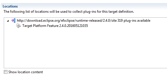

Re: Eclipse Neon 4.6.0 with E(fx)clipse 2.4.0 not working [message #1737150 is a reply to message #1737117] Wed, 06 July 2016 03:14 Go to previous messageGo to next message
Hi Dieter,
the features you have selected only have 55 plugins. Did you check the contents tab, if the plugins you are missing are there? I would assume not.
To get all the plugins you should select the the "Target Platform Feature" instead:
index.php/fa/26401/0/
I recommend not to put your eclipse installation ${eclipse_home} into your target platform definition. The efxclipse "Target Platform Feature" already includes a lot of the plugins you could need from the eclipse platform. If you need more you should manually add the specific features you need to the definition.
Cheers,
Christoph
Re: Eclipse Neon 4.6.0 with E(fx)clipse 2.4.0 not working [message #1737159 is a reply to message #1737117] Wed, 06 July 2016 03:45 Go to previous messageGo to next message
Well for a pure e4 application you should have selected only the "Target
Platform feature" who is self contained.
Tom
