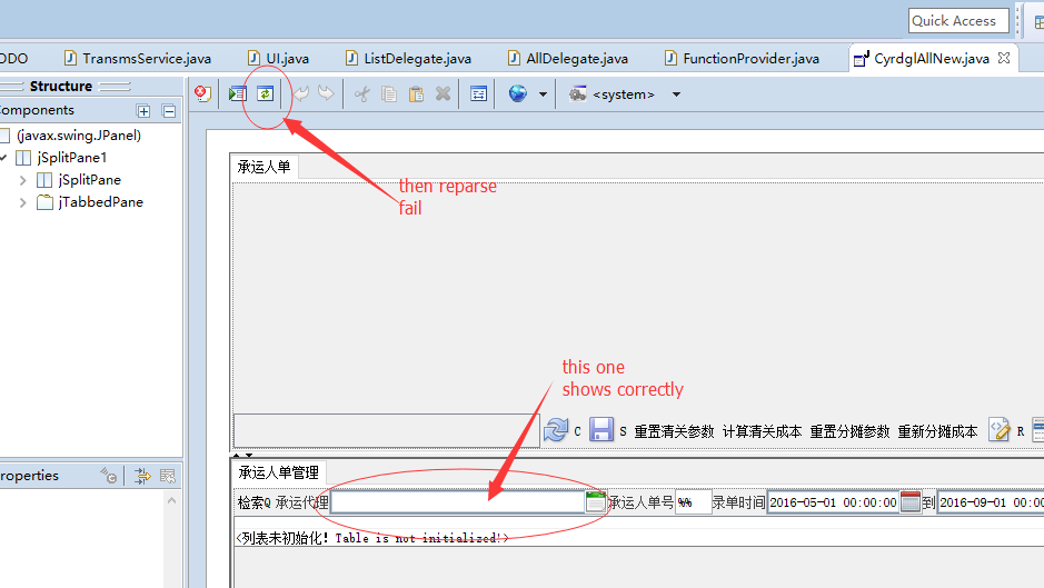

used to use Visual Editor, new to Window Builder
Eclipse Mars.2 Release (4.5.2)
WindowBuilder Version: 1.8.0
now i am using WB to open VE made JPanel class
and using @wbp.factory to mark the factory function
and it works like magic
until it comes to our CustomerComboBox
with create the CustomerComboBox,it fetchs data from remote server using hessian proxy
when we set the @wbp.factory and open the JPanel class, it looks fine, and the server logs the data fatch and returns data correctly, like this:
index.php/fa/26334/0/
then reparse
index.php/fa/26335/0/

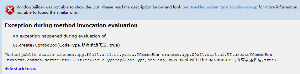

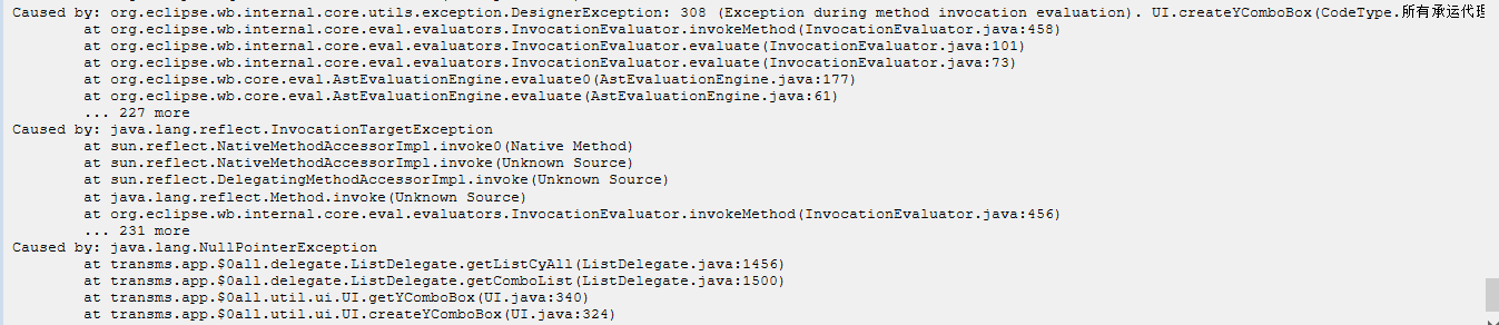

show stack trace.
index.php/fa/26336/0/

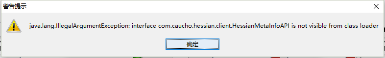

of course we try to debug this problem to the root of remote method invoke code and log the invoke exception:
index.php/fa/26337/0/

when we close the Eclipse, and open the JPanel class, and WB parse correctly, and then, close WB panel, clean project, rebuild project, can not fix the reparse fail
Only when we close Eclipse again, and reopen, and all is good, for the first parse, then reparse fail
