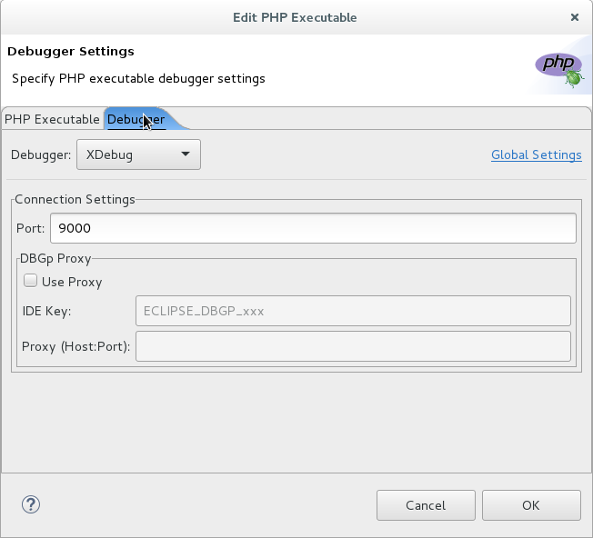

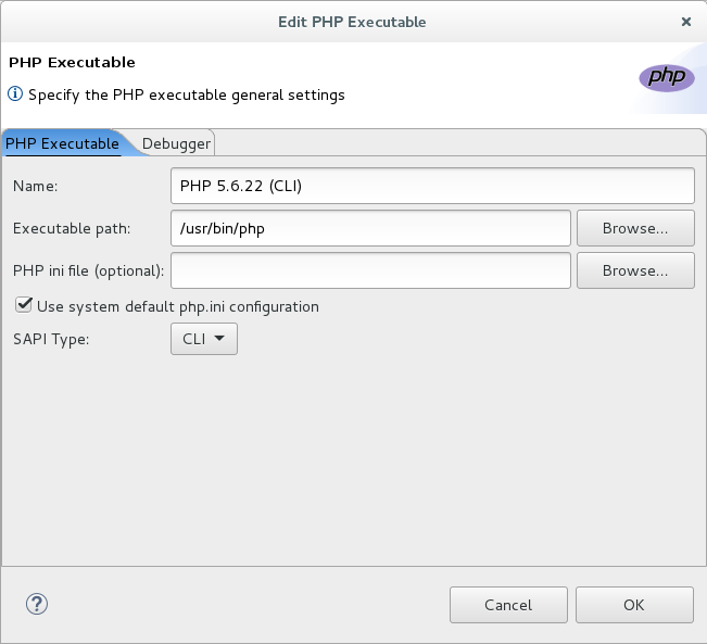

Re: xdebug + LD_LIBRARY_PATH [message #1737151 is a reply to message #1737109] Wed, 06 July 2016 03:17 Go to previous messageGo to next message
I tried Debian Testing, but installation failed from the netinst ISO.
So, I made a successful installation of Debian 8.5. I added the testing software repo.
Then I installed php5 + php-xdebug + some other extensions from Synaptic.
I installed Eclipse IDE for PHP Developers Neon release. I had no issue configuring and using the php5 stack installed from Synaptic.
Perhaps, it matters how you configure them in the PHP Executables preference page.
I attach screenshot of my configuration.
