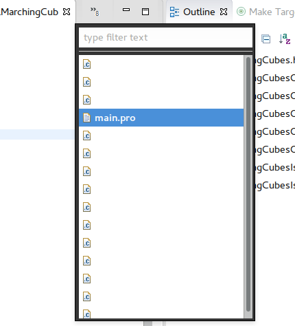

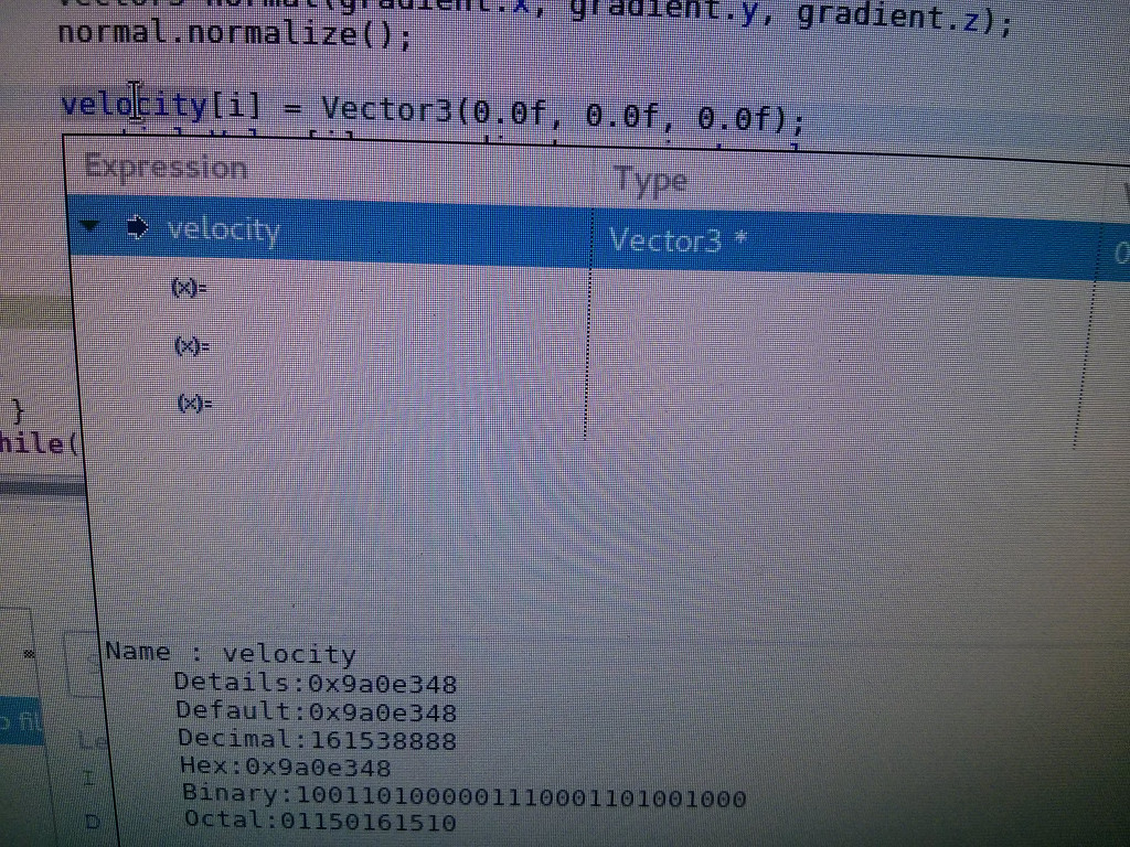

I've found another popup which has this error and a screenshot of that could be taken. I've also made a camera photo of the other popup I meant. Both are in the attachments.
I use the GTK theme and I tried other themes as well. No theme had these popups readable. I even use SWT_GTK3=0. I have tried using a screen capture utility, even delayed one. But still the popup closes. I even tried using a screencast software (gnome-shell) to record a video and then getting frames out of it, but the popup won't show then.

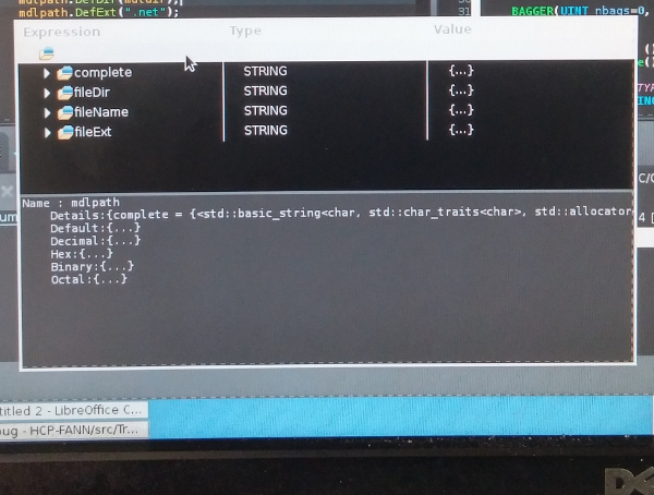

Here's what I get for a popup in the debugger:
index.php/fa/26350/0/

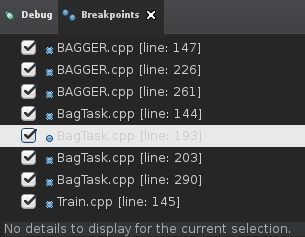

and here's the breakpoint view
index.php/fa/26348/0/
There is little difference between them. I haven't made any changes except to set the desktop theme (MurrinaCappuccino) and set the overall theme in Eclipse (Dark). As far as I know the color of the popups currently can't be easily changed with options.

As I've shown in one of my images, it is also in other popups (e.g. the file tab bar drop down). It is basically any interactive-list-popup I think.
