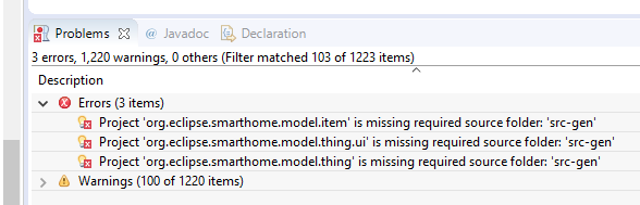

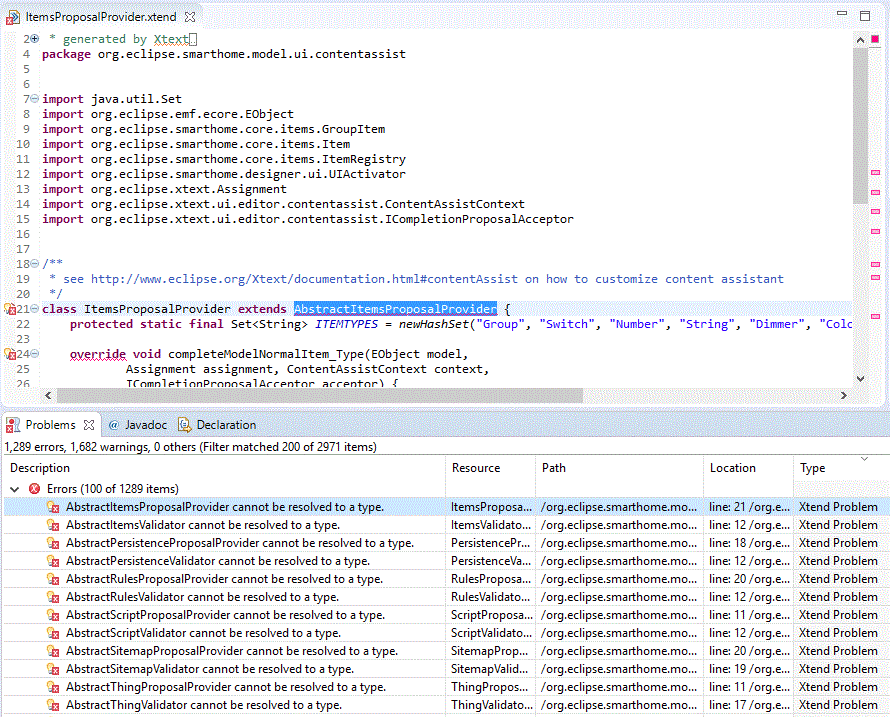

Re: Setup ESH development environment failed [message #1737539 is a reply to message #1737530] Sat, 09 July 2016 12:13 Go to previous messageGo to next message
Yes I followed the same steps from the "Setting Up a Development Environment" page.
I noticed these errors after I clean all projects. Did not build automatically.
See image.
I fixed the build-path to get rid of those errors.
But it looks like the code generated by xtext are having issues with missing classes.
See image.
[Updated on: Sat, 09 July 2016 12:26] by Moderator
Re: Setup ESH development environment failed [message #1737540 is a reply to message #1737539] Sat, 09 July 2016 12:20 Go to previous messageGo to next message
The missing src-gen folder of the model bundles looks like the model generation does not succeeded.
The model generation should be triggered by a setup task, so at step 8.
You can try to trigger the model generation yourself:
https://github.com/eclipse/smarthome/issues/1760#issuecomment-230324873
Another option would be to close the IDE, trigger a maven build and then start the IDE and perform a clean.
I will try a new installation myself and give you feedback if it is working for me.

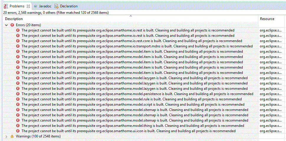

Re: Setup ESH development environment failed [message #1737551 is a reply to message #1737549] Sat, 09 July 2016 14:42 Go to previous messageGo to next message
In both Windows and Linux, the build was successful.
Opened the IDE, did a clean. No more errors!
Now under Run Configuration, ran SmartHome Runtime. Failed. see image
Example,
"The project cannot be built until its prerequisite org.eclipse.smarthome.io.rest is built. Cleaning and building all projects is recommended "
And so I did. And SUCCESS!
