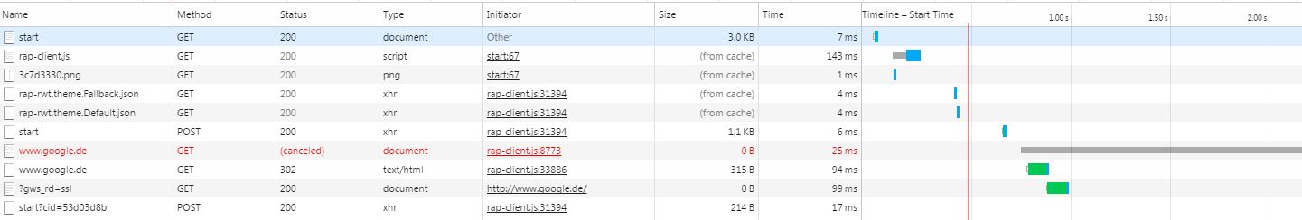

We used the Browser to download files as described in RAP FAQ and it worked fine so far. After upgrading to RAP 3.1 the following code produces two requests to the given url. Inspecting the network traffic in Chrome developer tools the first one is shown as canceled.

This behaviour is reproducable with any url (here: www.google.de), the network requests are shown below
index.php/fa/26315/0/
We see a strange request with status cancelled (marked red).
