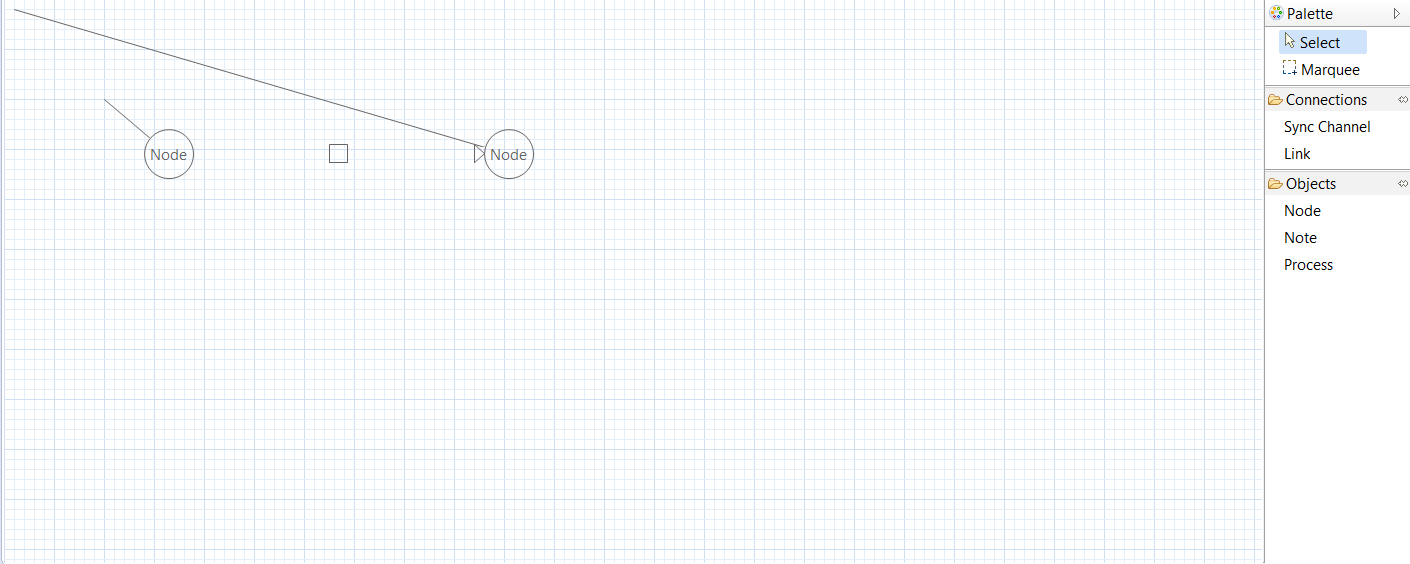

In my project I want to support ConnectionDecorators implemented as polygons that are not filled. If i just create a connection with a polygon connectionDecorator in the middle, the line from the connection goes straight through the connectionDecorator, as shown in attachment 1. Although is this exprected behaviour, it is not what I want. What I want to achieve is that the line of the connection does not cross the connectionDecorator.
I'm currenty trying the following approach, but I can't get it to work. Say you have node 'a', and node 'b' and you want to create a connection between a and b, with a decorator 'd' in the middle. First you create an invisible connection between a and b, that has d as visible decorator in the middle. Then you create a visible connection between a and d, and a visible connection between d and b. To be able to add connections to decorator d, d should have anchors. When I was testing this approach, I could not attach the connection with the anchor of decorator d, while graphiti does seem to support adding anchors to decorators. The problem seems to be that Graphiti does not recognise the location of the anchor of d, as is shown in attachment 2.

that is actually the expected behavior. All Graphiti connections are drawn on top of all other elements on the diagram. On the other hand anchors are only supported for shapes not for connection decorators.
I would suggest you create an intermediate shape with 2 anchors in the middle and connect your shapes from both ends. Working with the invisible connection behind will not help here.

Thanks for your reply. I guess that'll be the only option then. The disadvantage I see with that approach is that the shape meant as decorator will not move and rotate after one of the nodes is moved, like it would when using a real decorator. Maybe I can write some code to achieve the same.
