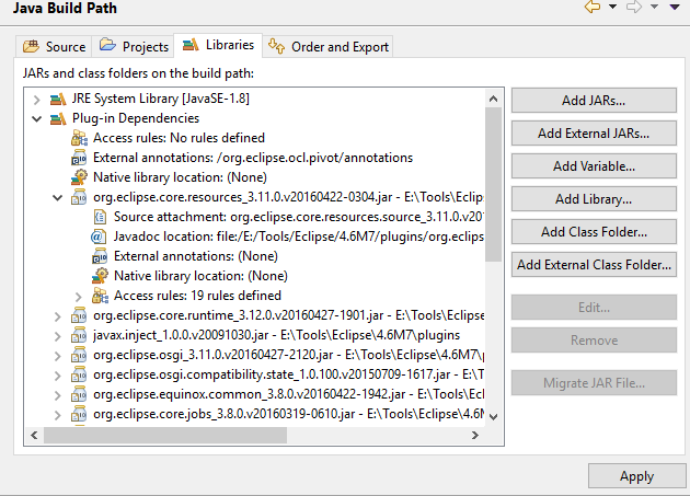

There was (seemingly still is) a confusingly dead ability to
specify annotations for each JAR. They should be specified twice,
once for the JRE and once for Plug-in Dependencies.<br>
