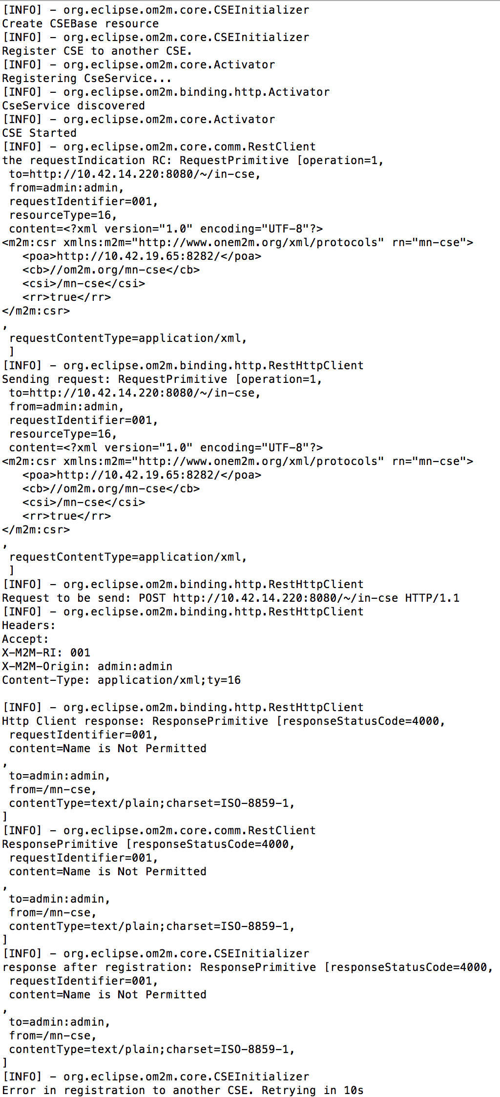

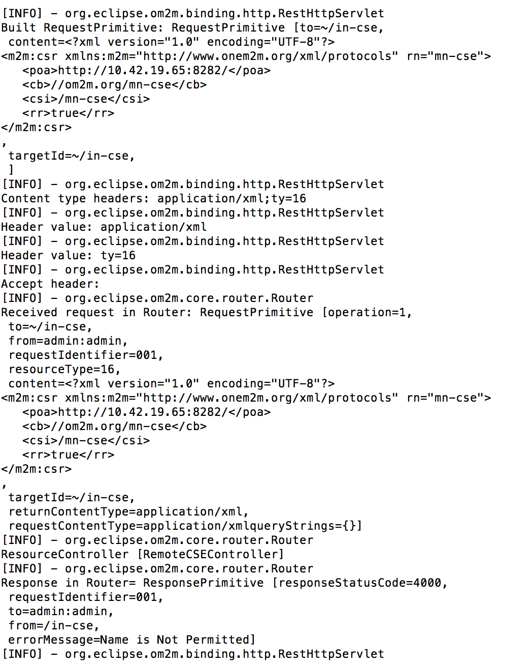

I start working on OM2M for about 2months and my purpose is to use Raspberry Pi 3 as a MN and my computer as an IN.
After a successful build in both of the two devices.
I am trying to add MN in my IN. but it showed up a error (Name is not permitted). Please see the screenshots below.
At the same time, i tried add MN(using the same pc of IN) in my IN, and it works.
Could you guys help me to walk out of this problem, thank you guys very much.

Re: problem when try to add mn(in Raspberry Pi) in my IN(pc) [message #1735892 is a reply to message #1735356] Thu, 23 June 2016 08:57 Go to previous messageGo to next message
First of all, I would like to ensure that you use the latest version of our code. Could you please try to pull the master branch of OM2M?
The oneM2M standard published an intermediary release recently and we implemented it. This could solve this error.
Guillaume
Re: problem when try to add mn(in Raspberry Pi) in my IN(pc) [message #1735912 is a reply to message #1735892] Thu, 23 June 2016 10:23 Go to previous message
Hello, guillaume
Thank you very much, i saw that there is a bug which is already fixed about this error, after build the latest release of OM2M, i solved this error. Smile
Best Regards
Can
