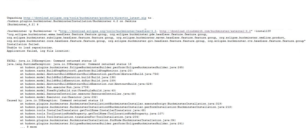

I am trying to build this project on jenkins with buckminster plugin. The buckminster build is working perfectly in my Eclipse but on Jenkins it gives the following errors.
Installation failed, Unable to load repositories.
i have attached the jenkins console output .
download.Cloudsmith.com is down . Is there any alternate mirror site.

The RC=13 usually indicates a problem with dependencies. What makes you think that download.Cloudsmith.com is down?
Can you attach the full log please, and as a text file, not as an image. What you originally posted is not enough to understand the problem.

I think you need to fix this first:
!MESSAGE Connection to http://download.eclipse.org/tools/buckminster/headless-4.2/p2.index failed on download.eclipse.org. Retry attempt 0 started
!STACK 0
java.net.UnknownHostException: download.eclipse.org
UnknownHostException?? Doesn't that suggest that there is something wrong with the setup on your Jenkins machine? Proxy maybe?
