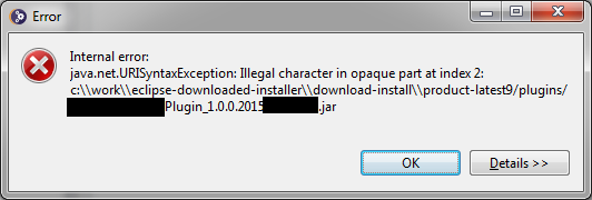

Hello everybody,
whenever I try to copy a file by the installer, I will get an error (see the attached file. For me it looks like an error, that only appears on windows systems...
Belonging to the attached file, the sign ":" is not allowed.
Is there an workaround to remove "c:" ?
Here is my task, that I am using.
<setupTask
xsi:type="setup:ResourceCopyTask"
excludedTriggers="STARTUP MANUAL"
sourceURL="setups/myPlugin.jar"
targetURL="${installation.location|property}/plugins/myPlugin.jar"/>
<description>Resource creation</description>
</setupTask>
