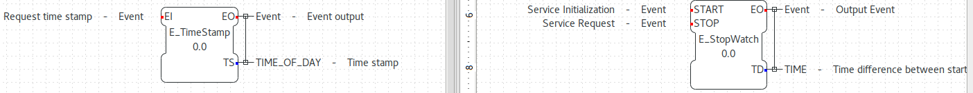

Today on my way home from work I spent some more thoughts on your question. I found out that we should have some FBs in 4DIAC which allow you to get some time information based on events. I came with the two FBs you can see in the attached figure:
  • E_TimeStamp gives you a time stamp value every time you trigger the EI input event.
  • E_StopWatch gives you the time duration that has elapsed between receiving a START and a STOP event
index.php/fa/26194/0/
Would such FBs be helpfull in for your work?
I even think these are FBs that should be suggested for the upcoming IEC 61499 update.

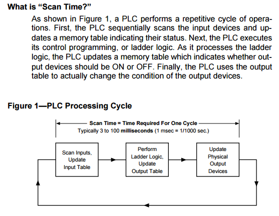

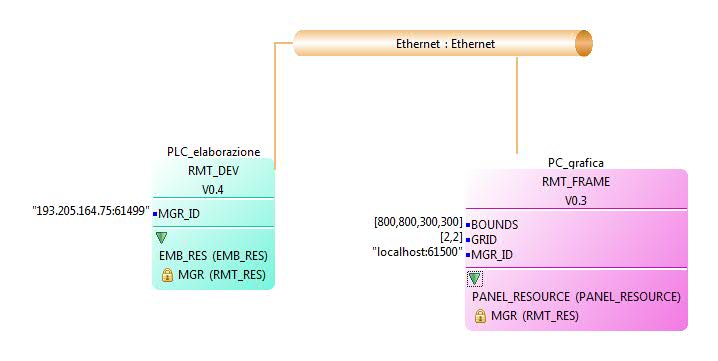

I mean the time scan in the PLC's processing cycle (sush as it indicate in photo).
Particurarly,I would calculate time scan of my program, decentralized on more machine (pc desktop and portable, sush as in photo), to understand what are the time game and to compare it with the response time that I expect.
In short, I would do an analysis of this type.

I'm working on this feature of my application.
I don't have problem in the use of "E_StopWatch" if the device on which is mapped it's a RMT_DEV.
But I don't succeed on a RMT_FRAME, with un "Unsupported Type error" in console.

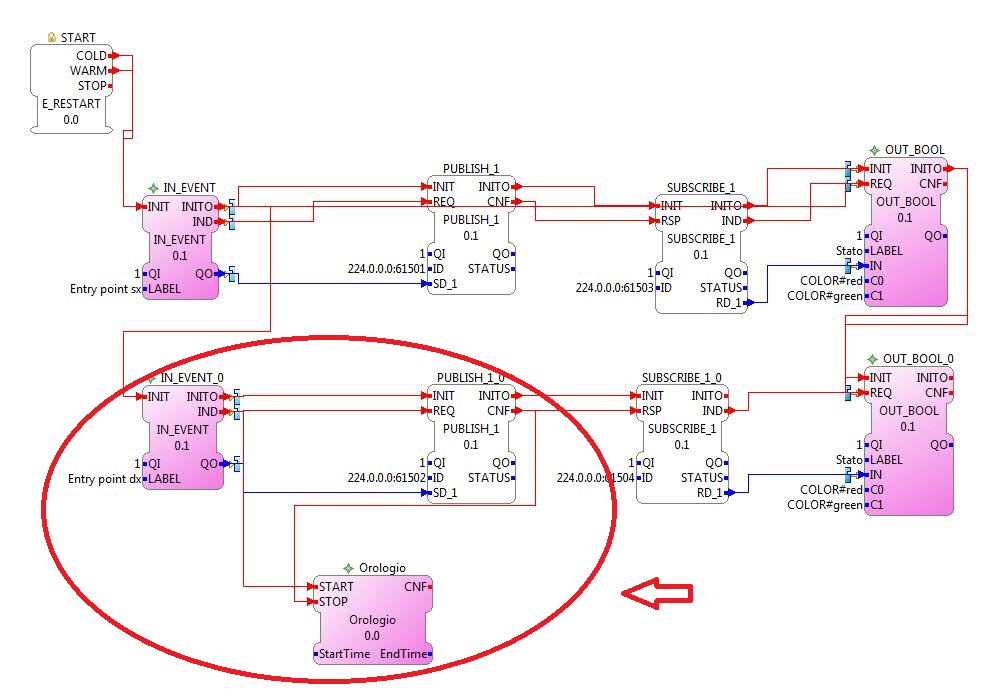

Can I, for example, compute the time beetween button click and a publication on a socket?
In attached, I show this situation.
Thank you.
Michele Citro
Re: How calculate time scan softPLC [message #1738827 is a reply to message #1738824] Mon, 25 July 2016 05:33 Go to previous messageGo to next message
RMT_FRAME devices utilize the FBRT provided by Holobloc Inc [1]. FBRT is implemented in Java. So in order to have also an E_StopWatch you need to implement it using the FBDK tool and adjust the generated Java code.
Alois
