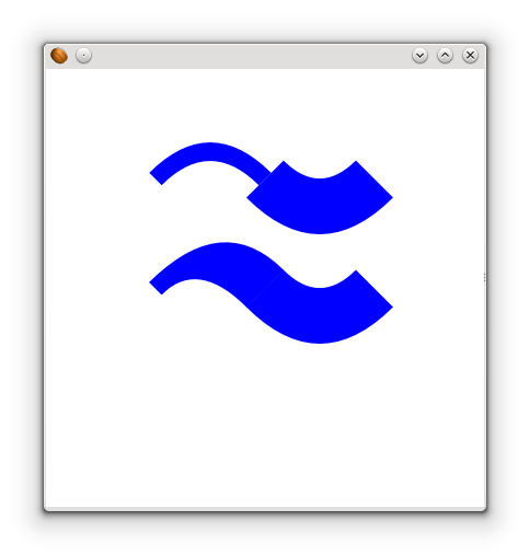

Ah, so that's what a hodograph is used for, I wondered about that Smile
Thanks Matthias, that's really cool. Actually, the shapes I'm joining together are constructed from QuadraticCurves rather than lines, so I have modified your example to create a PolyBezier from two new curves using the calculated offsets - I also offset the curve's control point in a similar manner to the start and end offsets. That produces a really beautiful effect, just what I was looking for. GEF4 rocks!

public class QuadCurveOffsetSnippet extends Application {
    launch();
  protected void addCurves(Pane root, double y, boolean transition) {
    // create curves
    QuadraticCurve firstCurve = new QuadraticCurve(100, y, 150, y - 50, 200, y);
    BezierCurve secondCurve = new QuadraticCurve(200, y, 250, y + 50, 300, y);
    // create paths
    Path firstPath = Geometry2Shape.toPath(firstCurve.toPath());
    Path secondPath = Geometry2Shape.toPath(secondCurve.toPath());
    // strokes
    double firstStrokeWidth = 16;
    double secondStrokeWidth = 48;
    // configure strokes
    firstPath.setStrokeType(StrokeType.CENTERED);
    firstPath.setStrokeWidth(firstStrokeWidth);
    firstPath.setStrokeLineCap(StrokeLineCap.BUTT);
    firstPath.setStrokeLineJoin(StrokeLineJoin.BEVEL);
    firstPath.setStroke(Color.BLUE);
    secondPath.setStrokeType(StrokeType.CENTERED);
    secondPath.setStrokeWidth(secondStrokeWidth);
    secondPath.setStrokeLineCap(StrokeLineCap.BUTT);
    secondPath.setStrokeLineJoin(StrokeLineJoin.BEVEL);
    secondPath.setStroke(Color.BLUE);
    // compute polygons to transition from the thinner/first curve to
    // the thicker/second curve
    if (transition) {
      // compute start point and end point
      Point startPoint = firstCurve.get(0);
      Point endPoint = firstCurve.get(1);
      Point controlPoint = firstCurve.getCtrl();
      // compute curve normals for start point and end point
      Vector startNormal = new Vector(firstCurve.getDerivative().get(0)).getOrthogonalComplement().getNormalized();
      Vector endNormal = new Vector(firstCurve.getDerivative().get(1)).getOrthogonalComplement().getNormalized();
      // compute left and right offset points for the start point (first
      // curve stroke width)
      Point startOffsetLeft = startPoint.getTranslated(startNormal.getMultiplied(firstStrokeWidth / 2).toPoint());
      Point startOffsetRight = startPoint.getTranslated(startNormal.getMultiplied(firstStrokeWidth / 2).toPoint().getNegated());
      // compute left and right offset points for the quadratic curve control point
      Point ctrlOffsetLeft = controlPoint.getTranslated(startNormal.getMultiplied(firstStrokeWidth / 2).toPoint());
      Point ctrlOffsetRight = controlPoint.getTranslated(startNormal.getMultiplied(firstStrokeWidth / 2).toPoint().getNegated());
      // compute left and right offset points for the end point (second
      Point endOffsetLeft = endPoint.getTranslated(endNormal.getMultiplied(secondStrokeWidth / 2).toPoint());
      Point endOffsetRight = endPoint.getTranslated(endNormal.getMultiplied(secondStrokeWidth / 2).toPoint().getNegated());
      // compute left and right curves for a smooth transition between
      // the stroke widths
      BezierCurve left = new QuadraticCurve(startOffsetLeft, ctrlOffsetLeft, endOffsetLeft);
      BezierCurve cap = new Line(endOffsetLeft, endOffsetRight);
      BezierCurve right = new QuadraticCurve(endOffsetRight, ctrlOffsetRight, startOffsetRight);
      PolyBezier cone = new PolyBezier(left, cap, right);
      // add to scene
      GeometryNode<PolyBezier> coneNode = new GeometryNode<PolyBezier>(cone);

Re: [GEF4] Calculation of stroke outline in model [message #1735282 is a reply to message #1735279] Thu, 16 June 2016 18:55 Go to previous messageGo to next message
Oops, just realized that the control point offset would be more accurate if it was using the derivative at the point of the curve closest to where the control point is, so when calculating the control offsets I changed it to:
      Point ctrlOffset = firstCurve.getProjection(firstCurve.getCtrl());
      Vector ctrlNormal = new Vector(firstCurve.getDerivative().get(firstCurve.getParameterAt(ctrlOffset))).getOrthogonalComplement().getNormalized();
      Point ctrlOffsetLeft = controlPoint.getTranslated(ctrlNormal.getMultiplied(firstStrokeWidth / 2).toPoint());
      Point ctrlOffsetRight = controlPoint.getTranslated(ctrlNormal.getMultiplied(firstStrokeWidth / 2).toPoint().getNegated());
Even that is not absolutely accurate - the amount by which the control point should be offset is proportional to how bendy that curve is, but my maths isn't good enough to figure out what that relationship is - but it's definitely something to do with the distance between the control point and the projection of the control point on the curve.
Re: [GEF4] Calculation of stroke outline in model [message #1735302 is a reply to message #1735282] Fri, 17 June 2016 04:32 Go to previous messageGo to next message
Hey that looks cool indeed!
I manipulated the code further to accurately align the shapes:
- Compute control points for cones so that C1 continuity is achieved.
- Set stroke to transparent for the cones to properly align the shapes.
		if (transition) {
			// compute start point and end point of the transition curve
			// compute derivatives for start/end
			BezierCurve derivative = firstCurve.getDerivative();
			Vector startDirection = new Vector(derivative.get(0));
			Vector endDirection = new Vector(derivative.get(1));
			Vector startNormal = startDirection.getOrthogonalComplement()
					.getNormalized();
			Vector endNormal = endDirection.getOrthogonalComplement()
					.getNormalized();
							.getNegated());
							.getNegated());
			// compute control points by intersecting the derivatives through
			// the offsetted start/end points to achieve C1 continuity
			Straight s1Left = new Straight(new Vector(startOffsetLeft),
					startDirection);
			Straight s2Left = new Straight(new Vector(endOffsetLeft),
					endDirection);
			Vector ctrlOffsetLeft = s1Left.getIntersection(s2Left);
			if (ctrlOffsetLeft == null) {
				ctrlOffsetLeft = new Vector(endOffsetLeft);
			Straight s1Right = new Straight(new Vector(startOffsetRight),
					startDirection);
			Straight s2Right = new Straight(new Vector(endOffsetRight),
					endDirection);
			Vector ctrlOffsetRight = s1Right.getIntersection(s2Right);
			if (ctrlOffsetRight == null) {
				ctrlOffsetRight = new Vector(endOffsetRight);
			org.eclipse.gef4.geometry.planar.Path leftCone = new org.eclipse.gef4.geometry.planar.Path(
					new Segment(Segment.MOVE_TO, startOffsetLeft),
					new Segment(Segment.QUAD_TO, ctrlOffsetLeft.toPoint(),
							endOffsetLeft),
					new Segment(Segment.LINE_TO, endPoint),
					new Segment(Segment.QUAD_TO, firstCurve.getCtrl(),
							startPoint),
					new Segment(Segment.CLOSE));
			org.eclipse.gef4.geometry.planar.Path rightCone = new org.eclipse.gef4.geometry.planar.Path(
					new Segment(Segment.MOVE_TO, endOffsetRight),
					new Segment(Segment.QUAD_TO, ctrlOffsetRight.toPoint(),
							startOffsetRight),
					new Segment(Segment.LINE_TO, startPoint),
							endPoint),
			Line capLine = new Line(endOffsetLeft, endOffsetRight);
			// create corresponding JavaFX shapes
			Path leftConeShape = Geometry2Shape.toPath(leftCone);
			Path capShape = Geometry2Shape.toPath(capLine.toPath());
			Path rightConeShape = Geometry2Shape.toPath(rightCone);
			// style the shapes for accurate alignment
			leftConeShape.setStroke(Color.TRANSPARENT);
			leftConeShape.setFill(Color.BLUE);
			rightConeShape.setStroke(Color.TRANSPARENT);
			rightConeShape.setFill(Color.BLUE);
			capShape.setStroke(Color.BLUE);
			capShape.setStrokeLineCap(StrokeLineCap.BUTT);
			// add to scene
			root.getChildren().addAll(leftConeShape, capShape, rightConeShape);
Screenshot:
index.php/fa/26197/0/
Matthias
[Updated on: Fri, 17 June 2016 04:34] by Moderator
