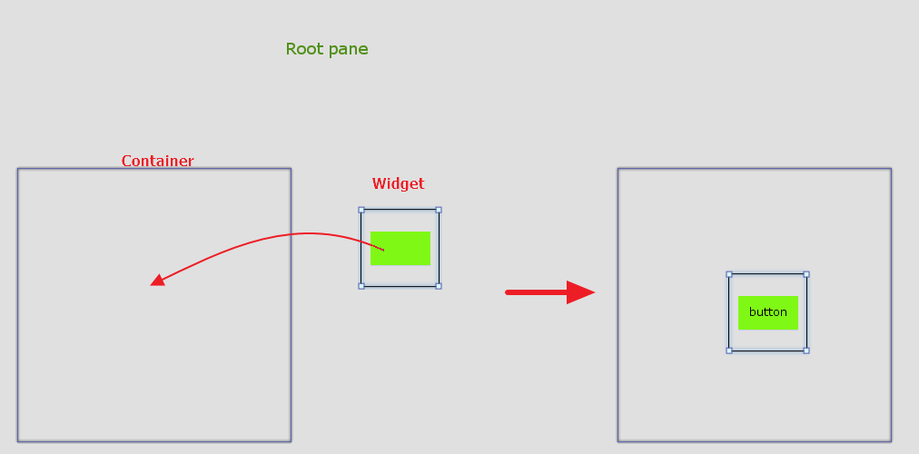

Re: [GEF4] Cross container drag and drop with JavaFX [message #1734843 is a reply to message #1734737] Mon, 13 June 2016 08:57 Go to previous messageGo to next message
Hello Matthias,
Thank you for making an effort to understand my questions. I'm attaching an image that should help you understand the app better. It is indeed a software that has some UI designer features.
When I say widgets i mean my part classes that extend an abstract class that extends AbstractFXContentPart<StackPane>. Both widgets and containers extend that abstract part class and they both have a local StackPane which they return on createVisual. That stack pane also holds an instance of an object extending JFX Control that represents the actual widget visual content. For basic widget parts on top of that there's another StackPane in order to soak up the events going through to JFX controls that blocks events from falling through to JFX controls (I've tried setMouseTransparent earlier, before adding the second StackPane on top, couldn't make it work because FXFocusAndSelectOnClickPolicy click didn't trigger for some reason).
Containers are implemented in a similar way. The inner stack pane holds an instance of a class that extends JFX Control. That instance holds the list of JFX Nodes and when I call the addChildVisual or removeChildVisual that I've Overriden in my part class, I'm basically modifying that list. A similar list exists in the model as well and it's modified in Overriden addContentChild and removeContentChild by calling getContent().removeWidget(modelClassInstance) or something similar.
All of these things are placed on an instance of a class that extends AbstractFXContentPart<Group> that I treat as editor surface root part. The real FXRootPart content layer is a parent of this instance. I hope I have managed to clarify a bit what the code organization looks like. Please feel free to give any suggestions to how I can improve the things I'm working on since I'm having quite a few issues (when transporting a basic widget from "Root part" to the container part on drag, my drop event ends up on a totally different place etc.)
EDIT: What is called "Root part" on the image is actually an object extending AbstractFXContentPart<Group> as described earlier.
