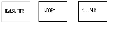

And an outline of what I want to be displayed :
index.php/fa/26082/0/
I have tried to create a node mapping for those elements in the VSM but it is not working because the class of the elements on the list is not recognized (nothing is displayed)
Do you know if what I want to do is possible ?

Re: Display properties semantic elements on diagram [message #1734472 is a reply to message #1734252] Wed, 08 June 2016 11:05 Go to previous messageGo to next message
Hi Alexandre,
If I understand your need, you want display the enum's litterals?
You can find attached, an example to do that.
Julien - Obeo
Re: Display properties semantic elements on diagram [message #1734538 is a reply to message #1734472] Thu, 09 June 2016 05:23 Go to previous message
Hi Julien,
Thank you very much it works !
I just did the enum literals finding inside a java service to make it a bit easier but the principle is the same.
Alexandre.
