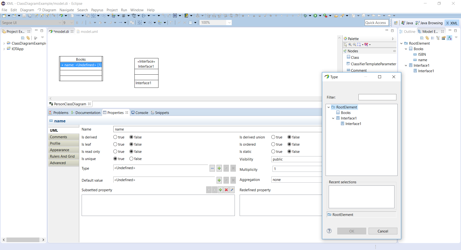

i an unbable to set value for type attribute in class diagram using papyrus plugin [message #1734201] Mon, 06 June 2016 03:03 Go to next message
and i am unable to import java datatypes in my class diagram can anybody help me for this
  • Attachment: newwaatt.PNG
    (Size: 113.94KB, Downloaded 231 times)

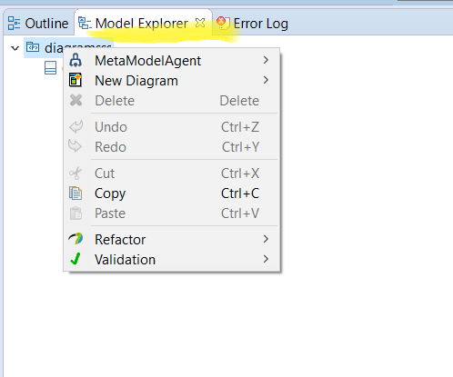

Re: i an unbable to set value for type attribute in class diagram using papyrus plugin [message #1734344 is a reply to message #1734341] Tue, 07 June 2016 06:21 Go to previous messageGo to next message
im also doing that in model explore please check the attachment
  • Attachment: noimport.png
    (Size: 23.98KB, Downloaded 448 times)
Re: i an unbable to set value for type attribute in class diagram using papyrus plugin [message #1734347 is a reply to message #1734344] Tue, 07 June 2016 06:48 Go to previous messageGo to next message
I don't know what Papyrus version are you using.
Right-clicking in the root of the model (a profile model in your case)
works for me to import the types.
Best,
Víctor López
