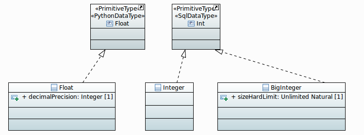

I have the following model fragment:
index.php/fa/26159/0/
My desire is to be able to percolate down the to the origin of the class
and then to the primitive type and last but not least to the InstanceClassName
of the 'SqlDataType'.

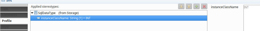

Which is from the profile set on the 'Int' class, as seen in the image.
index.php/fa/26160/0/
That 'Int' class is linked into the model, imported from the packate Sql, as seen in the image:
index.php/fa/26161/0/

I need the way to access the information that is set as a value for the instanceClassName (Which is INT).
The longest I could reach is this (you can see this in the complete output above):
	instanceClassName::::::: "org.eclipse.uml2.uml.internal.impl.PropertyImpl@741b3bc3 (name: instanceClassName, visibility: <unset>) (isLeaf: false) (isStatic: false) (isOrdered: false, isUnique: true, isReadOnly: false) (aggregation: none, isDerived: false, isDerivedUnion: false, isID: false)"

I honestly don't know what's happening in this case. The stereotype seems to be found, but a "string" it's supposed to hold isn't? This is an UML question more than an Acceleo one tbh.
Just in case, have you properly initialized the UML resource set before loading the models? You're supposed to use "UMLResourcesUtil.init(ResourceSet)" (or follow the instructions in the UML FAQ to initialize your resource set for standalone use in the generated acceleo launcher's "registerPackages" class. I'm not that familiar with UML, but I guess you also have to register the "sql" profile the same way?
Laurent Goubet
