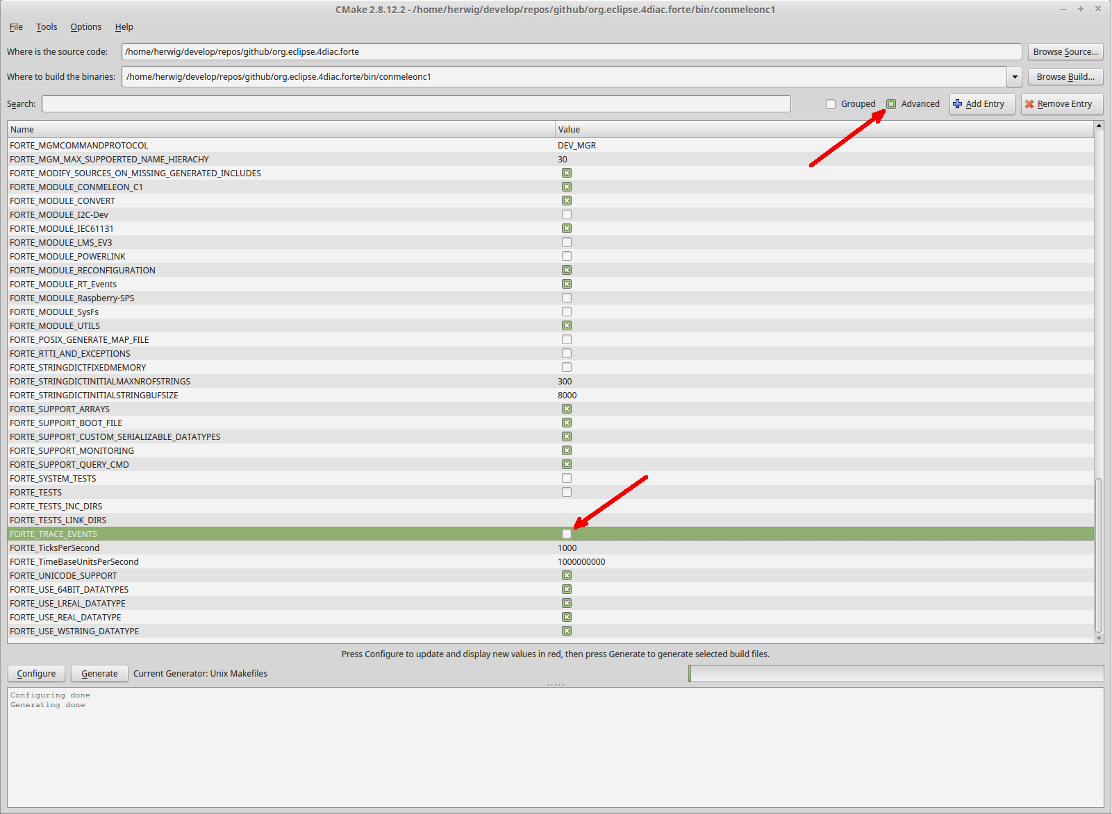

Hi Alois,
thanks, found it!
I have attached a screenshot indicating the settings when using CMAKE GUI.
greetings
Herwig
