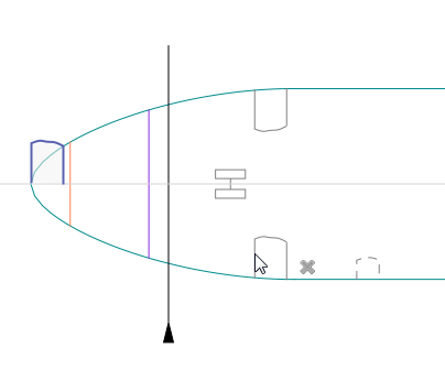

I'm trying to upgrade my application to GEF4.0.0 RC2.
I have a strange behavior with the hover feedback. Now (as you can see on the image) the hover feedback is translated to the 0,0 location of the canvas...
index.php/fa/26001/0/
I found the GEF4 code change causing this problem but I don't manage to understand the purpose of your change.
Previously in NodeUtils class you had line 345 this code that provides the geometry hover feedback, it was working fine for me
else if (visual instanceof GeometryNode) {
			return ((GeometryNode<?>) visual).getGeometry();
Now it is
			GeometryNode<?> geometryNode = (GeometryNode<?>) visual;
			IGeometry geometry = geometryNode.getGeometry();
			if (geometry != null) {
				return geometry.getTransformed(new AffineTransform().translate(
						-geometryNode.getLayoutX(),
						-geometryNode.getLayoutY()));
The layoutx and y of my nodes are not null so the hover feedback get translated to the 0,0 location of the canvas.
We don't set manually the layoutx and y, it is setted when we call the set Geometry function in GeometryNode.
We are really stuck with this issue, if you can maybe point us to a direction where to look at in the code or is it a bug?
Thank you.

As GeometryNode is now based on Region, its layout bounds are fixed to (0, 0, width, height). We interpret the position information within its Geometry as its layoutX, layoutY values, so literally speaking the geometry reflects the boundsInParent of the GeometryNode. The translation within NodeUtils has been added to compensate this (as it should retrieve a geometry within the local coordinate system of the given node, not its parent). It seems as if a translation (localToParent/parentToLocal) is missing in some place. How do you position your nodes?

supplementary to Alexander's replies, you can check what geometry provider is used for hover feedback and how the hover feedback part factory transforms the provided geometry. In the Logo example, the GeometricOutlineProvider is used and the FXDefaultFeedbackPartFactory transforms the provided geometry from the local coordinate system of the target node into the coordinate system of the scene. Possibly, in your case, either the geometry provider does not return the geometry in local coordinates of the target node, or the transformation from local to scene coordinates within the factory is incorrect.
For debuggin purposes, you can output the target node and its local-to-scene-transformation within the factory, and you can output the provided geometry within FXHoverFeedbackPart#doRefreshVisual(), which should be in parent coordinates, as well as the feedback part visual's local-to-scene-transformation, which should reflect the translation.

Our problem comes when we are using Group as visual.
We have already overridden your GeometricOutlineProvider to make it work for Group, we put the outline in the first children of the group and our provider returns this geometry for the hover feedback.
I think the problem can come from interaction between group and its children we update directly, we will further investigate.
We have not so much time to analyse deeply the problem and ended up bypassing your NodeUtils for Group visuals.
Re: Problem with hover feedback geometry with GEF4.0.0RC2 [message #1733440 is a reply to message #1733439] Fri, 27 May 2016 09:49 Go to previous messageGo to next message
I suppose the problem then is that the geometry that is inferred from the first child has to be translated into coordinates of the group, using something like NodeUtils.localToParent(firstChild, geometry).
Re: Problem with hover feedback geometry with GEF4.0.0RC2 [message #1733499 is a reply to message #1733440] Sat, 28 May 2016 16:45 Go to previous messageGo to next message
I have a pretty similar situation. I have around 40 different parts, most of which use a GeometryNode as the visual, but a handful use Group instead. The ones that use Group add an invisible GeometryNode with the model object's outline geometry, which is used by the geometry provider. After picking up these changes, I also had to add the localToParent conversion as Alexander says. Here is my geometry provider:

Incidentally, this change also affects how you interpret mouse events in the part geometry. Previously, in my IFXOnClickPolicy and IFXOnDragPolicy classes, I was just using Node.sceneToLocal() to convert the mouse event sceneX() and sceneY() to a point that I could use in model coordinates. However, that will now always return a point in reference to the (0, 0) origin of the Region, so you need to do a two-step transform to get the point back into the parent coordinates of the GeometyNode. I added a method to my base TerrainPart, again using the getGeometryOutline() method to get the model's geometry, as follows:
  public Point sceneToLocal(double sceneX, double sceneY) {
    GeometryNode<?> outline = getGeometryOutline();
    Point local = NodeUtils.sceneToLocal(outline, new Point(sceneX, sceneY));
    return NodeUtils.localToParent(outline, local);
Here's an example of this being used. This is an IFXOnDragPolicy that rotates a part, so I want to calculate the new angle of rotation from the current position of the mouse relative to the current location of the model object. Geometry.getAngleFrom() is a utility method of mine that returns the angle (as a clockwise rotation from the X-axis) from point A to point B. Obviously, those two points both need to refer to the same coordinate space for it to compute the angle correctly.

Thank you so much for these very useful information.
It was the problem and your code example works nicely.
