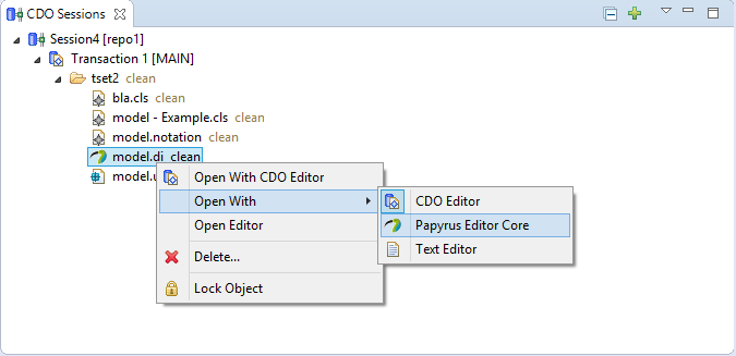

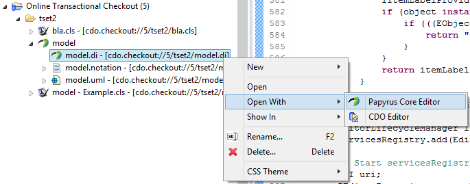

Dear all,
I use a CDO repository to store my Papyrus model. I can properly open and use the Papyrus editor on an Online Transactional Checkout folder in my project explorer. The editor, however, crashes when I try to open it on the same di file but within an explicit transaction. The exception I receive is
java.lang.ClassCastException: org.eclipse.emf.cdo.internal.ui.CDOLobEditorInput cannot be cast to org.eclipse.ui.IURIEditorInput

Do you have any idea about what I am doing wrong?

The way I want to open the editor is shown in the attachment (papyrus_session.png). This results in the mentioned exception. When using the transactional checkout (papyrus_checkout.png) the editor is started without any problem. I would assume both ways to work as the UI provides the ability to open the Papyrus editor in the given contexts.
So, is this a bug or did I miss something important?
Best regards
Stephan

On 2016-05-20 03:34:51 +0000, Stephan Seifermann said:
> Hello Christian,
> I installed the extra plugin:
> Papyrus CDO Integration (Incubation) 1.1.4.201602101324
> org.eclipse.papyrus.extra.cdo.feature.feature.group
> Best regards
> Stephan

Hello Christian,
thanks for your answer. You are right, both paradigms that use checkouts work. My use case, however, was to not checkout the repository but directly edit the resources in a transaction. There seems to be a difference in the editor input given to Papyrus in these two scenarios.
The pointer you sent to me does not mention the sessions view that I use. Therefore, I think this is simply not supported and most probably not necessary in most use cases. I will just use the checkouts to edit the resources.
Best regards
