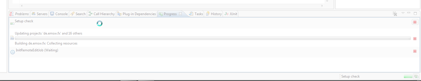

It seems I have somehow killed my workspace. When I open Eclipse (Mars.2) it starts out fine. Then the Job "Setup check" kicks in. After this I cannot use the application anymore: It is blocked. So I also can't stop any running jobs.
index.php/fa/25956/0/
I am working on Windows using JDK 1.8.0_66.
Has anybody seen this before? Is there something I can do to repair my workspace? It's a bitch to setup and I don't really want to do that again Sad.
Any tips are highly appreciated!
Christoph
