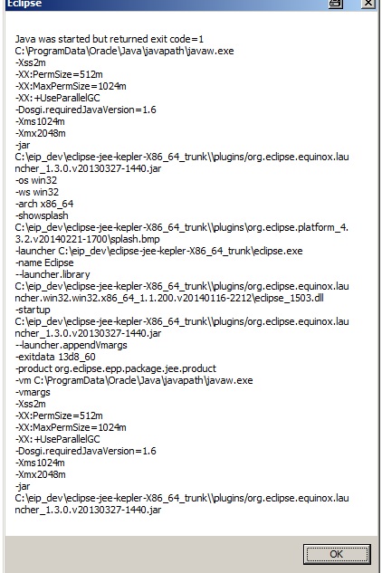

Dear Eclipse Team!
After 1 year pause i opened eclipse to continue an old projcet.
But can't open because java linked problem.
I already did:
Reinstall all Java JDK & Environment Versions and install JDK 6.45 & JRE 8.x;
Checked linking in .ini files if correct linked to java
Attached the full message of the error.
May u know a solution, thanks!
  • Attachment: screnshot.jpg
    (Size: 96.75KB, Downloaded 164 times)
Re: Java returned exit code = 1 [message #1732628 is a reply to message #1732595] Wed, 18 May 2016 11:49 Go to previous message
Michael,
Perhaps is similar to this:
https://www.eclipse.org/forums/index.php/t/198527/
Try to point the eclipse.ini at an exact version of Java (with matching
bitness).
