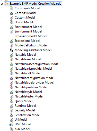

Hi Guys,
According to tutorial "Papyrus Palette Customization UI" it should be an option to export palette or to create own palette from File->New->Example EMF Model CreationWizard ->Palette Configuration Model.
I use newest eclipse Mars with modeling tools and installed all papyrus extensions but both options are not accessible. Could you help me what should i install to create custom palette or export it to file?

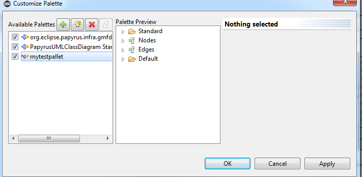

Hello again,
I tried several ways to find a solution and ended up finding the xml file corresponding to the customized palette.
In your workspace //.metadata\.plugins\org.eclipse.papyrus.uml.diagram.common you see all the customized palettes you have and copy the one you need to import.
To import you need to open eclipse to the new workspace and customize a palette (just that the folder can be created and the palette initialized with the right ID).
Now go copy the initial customized palette to the new workspace and rename it as the name of the new created palette (Delete the new created one, we just need its name)
Restart eclipse to the new workspace and voila Smile
Re: Export Palette to file [message #1733927 is a reply to message #1733566] Thu, 02 June 2016 05:37 Go to previous message
Thanks Elio it works very well.
