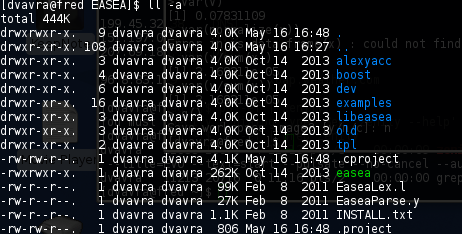

This is the listing of files in a directory named EASEA
index.php/fa/25927/0/
And this is the project view after creating the project.
index.php/fa/25928/0/

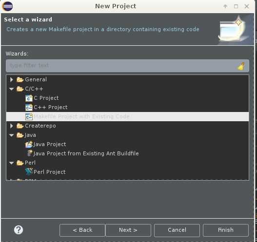

Well, I'm using MARS.1 and contrary to the mars sr1 documentation:
http://help.eclipse.org/mars/index.jsp?topic=%2Forg.eclipse.cdt.doc.user%2Freference%2Fcdt_u_new_proj_wiz.htm&cp=10_4_8
I get this after File --> New --> Project
index.php/fa/25939/0/
According to this:
http://help.eclipse.org/mars/index.jsp?topic=%2Forg.eclipse.cdt.doc.user%2Fconcepts%2Fcdt_c_projects.htm
Makefile Project - Creates an empty project without the meta-data files.
Whatever that means. If your project is truly empty then I guess you need to use File --> Import after creating the project.
There must be a .cproject file in the main project directory and that should show up in the project view unless it is being filtered.
What I don't understand is that when you target your project to the Debug you apparently have the files and the project is not empty. The only difference is that your project has only directories. There should be a directory structure in the project. When I do it, I get the expected structure. Maybe it's a bug or maybe not. Eclipse documentation is not entirely reliable. Menus changes seem to occur with every release. So, who knows?
